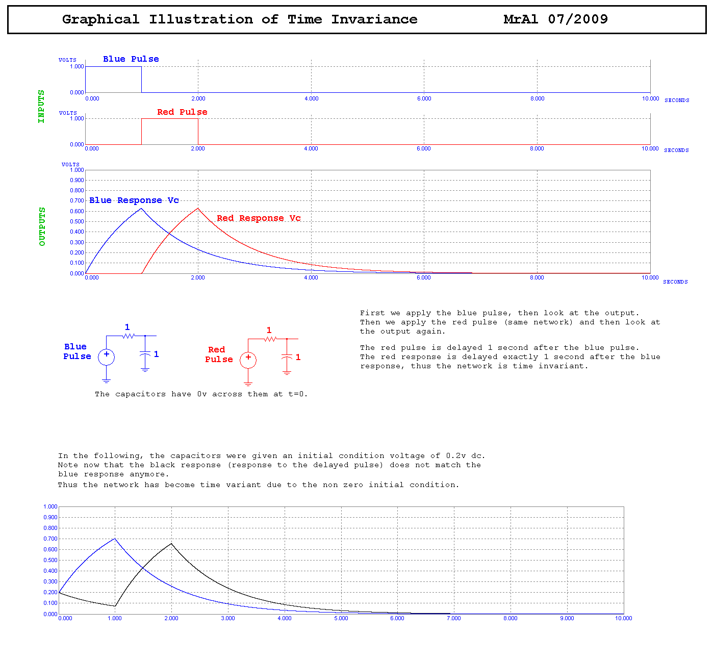

Hi again,
Here is a graphical illustration of time invariance (and time variance) of a
network for those interested in this view which makes things a little clearer.
The math behind this is as follows:
The first pulse is made from two unit steps, one plus and one minus,
spaced 1 second apart. This creates a pulse from t=0 seconds to
t=1 seconds. This input is then convolved with the impulse
response of the network, and the output becomes y1(t).
The second pulse is also made from two unit steps, spaced 1 second apart,
but also delayed by 1 second (tau). This creates a pulse from t=1 second to
t=2 seconds. This new input is then convolved with the impulse response
of the network, and the output becomes y2(t).
We next substitute t-tau into y1 to get y1(t-tau) instead of y1(t).
Now if y1(t-tau)=y2(t) the network is time invariant.
The only caution when doing the math is that there are two parts to each
pulse response, the charging time and the discharging time, which have to be
handled separately.
As shown graphically, when we apply non zero initial conditions we end
up with a time variant network.
Here's the graphic:
