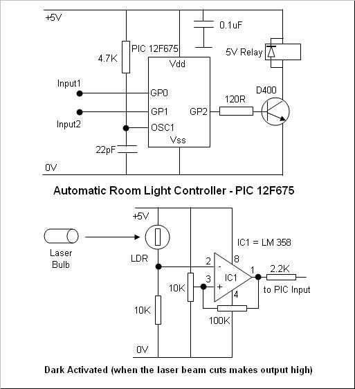

That is the hardest part.My room light controller I have configured to operate like this.

Thanks to both of you it gives me some place to start, I was wondering (it's been about 15 yearstrying to get back into it) any suggestions on links or areas to search for ultrasonic or PIR circuit designs also?
Gayan, when you said that was the hardest part did you mean the area to cover to allow the circuit to pick up motion? Also, the circuit that was included (thanks again!) does it turn off the light as you leave the area?

Hello again, by the way I was starting to research these chips the PIC12f675 and the lm358 ic, it looks like the IC is only 30 volts or less and the pic chip needs to be programed-am I correct?
The PIC is 5V and the LM358 opa is about 30V.
The PIC needs a program.

The PIR Motion sensors works if there is some motion in your room or in your kitchen.
The distance & the angle that works the PIR Motion sensors is quit enough for a room or a hall. The thing is it if there is no motion then it won’t give any output.
Most PIR Motion sensors I have seen they are design to apply a front door of a shop or the main door in the house instead of ringing a bell it will automatically ring a sound or light.
Apart from that to design a fully automatic room light is a pretty challenge.
Anyway my method is hard for you. Just get an idea.
How my design works
When a person enters in a room it will turn on the output & if the person leaves the room it will switch off the output.
If you are inside the room the light will be turned on, if another person comes it will still stay turned on. The light will be turned off all the people’s leaves the room. That is the nice part in the design.
