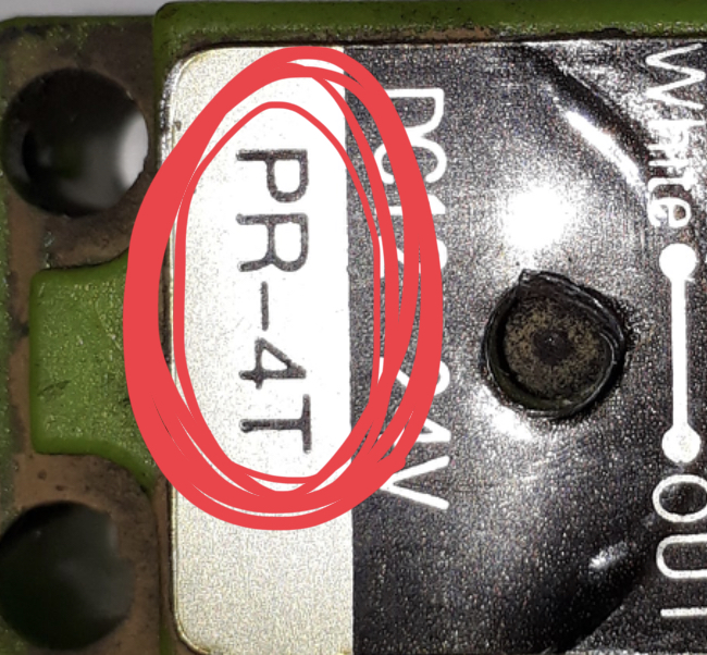

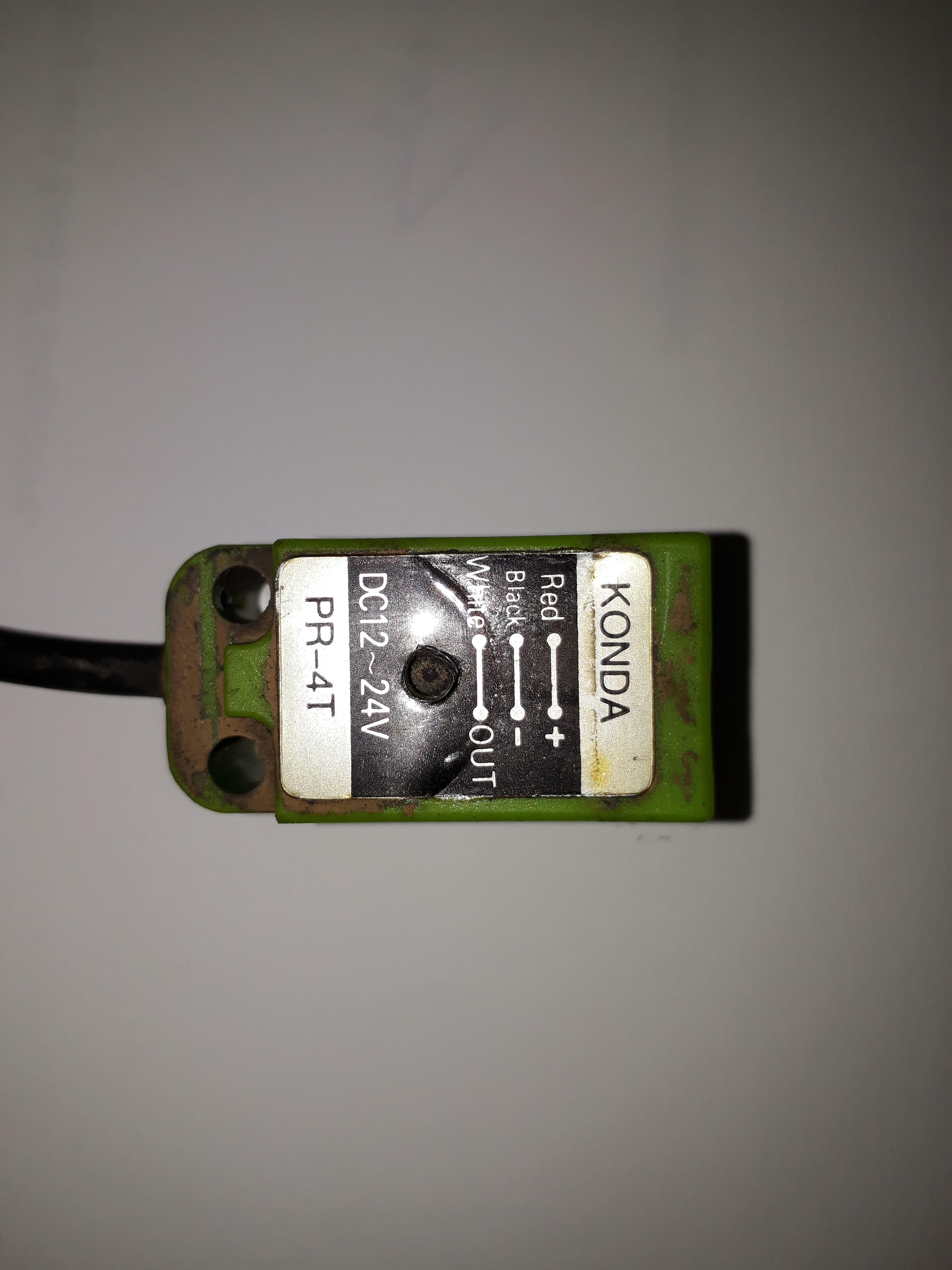

hi. I need to replace this proximity sensor. Can anyone tell me what specs it is so I wont be in the dark when I go to the store to buy it? is it a NPN or PNP? It is installed in a delta CTA4100A counter which can be configured to either PNP or NPN input. Can anyone tell me also what would happens if I connect a NPN sensor to a PNP input or a PNP sensor to a NPN input? Thanks

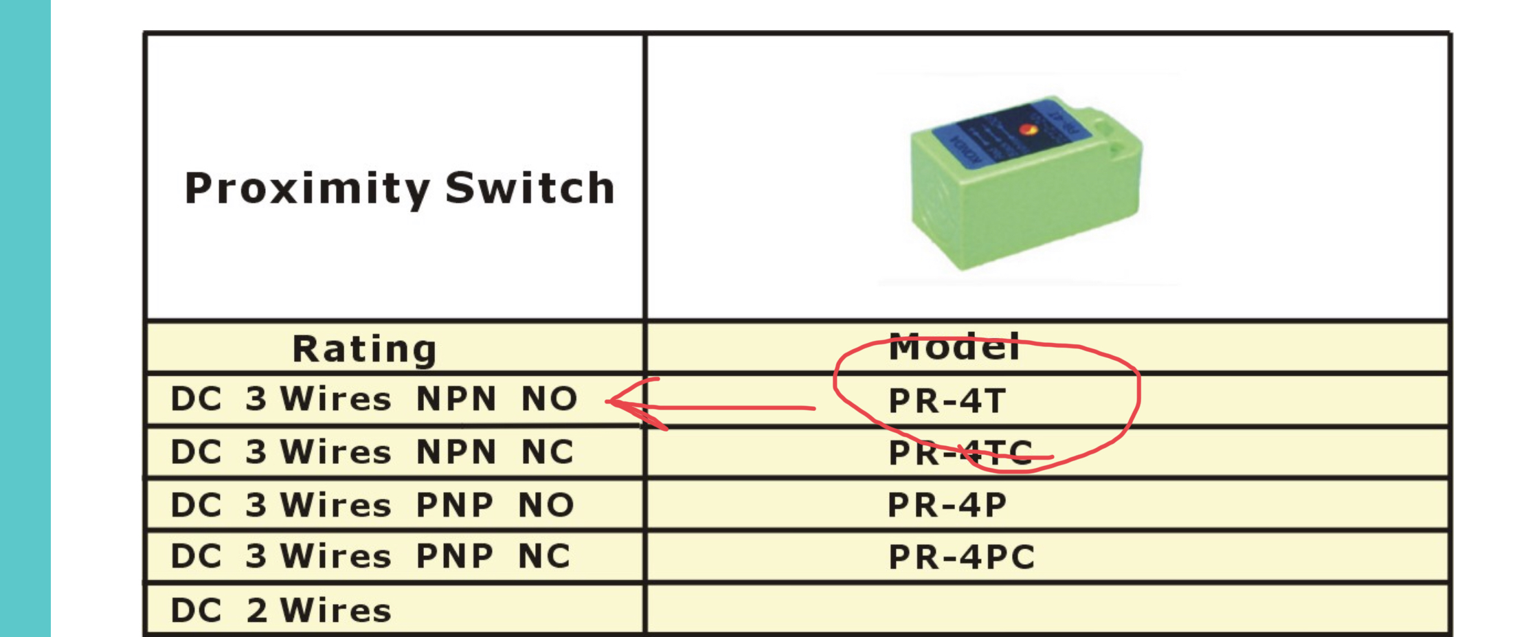

If you bother to read the link that Nigel provided in post #2 then you can install the CORRECT type.

Why don't you just order the correct one? The model number is right in your photo.

If you use the wrong type then it's the wrong polarity, and most probably won't work at all.
You simply need to buy the correct type, and I would imagine the one you've got is by far the most common?.

I've ordered the $3.50 part from china and it should arrive in 2 weeks time. in the meantime, I reconnected my old PR-4T which with the help from gophert is a 3 wire NPN NO proximity switch. Ive noticed on my counter(Delta CT4100A) that the input was set to PNP so I changed it to NPN. It also works. My question is why does my proximity sensor work whether the input is set for PNP or NPN ? I still have to try it tomorrow to see if the counter would skip during normal operation. I tested it today and it did not skip during the 5 minute test run.
