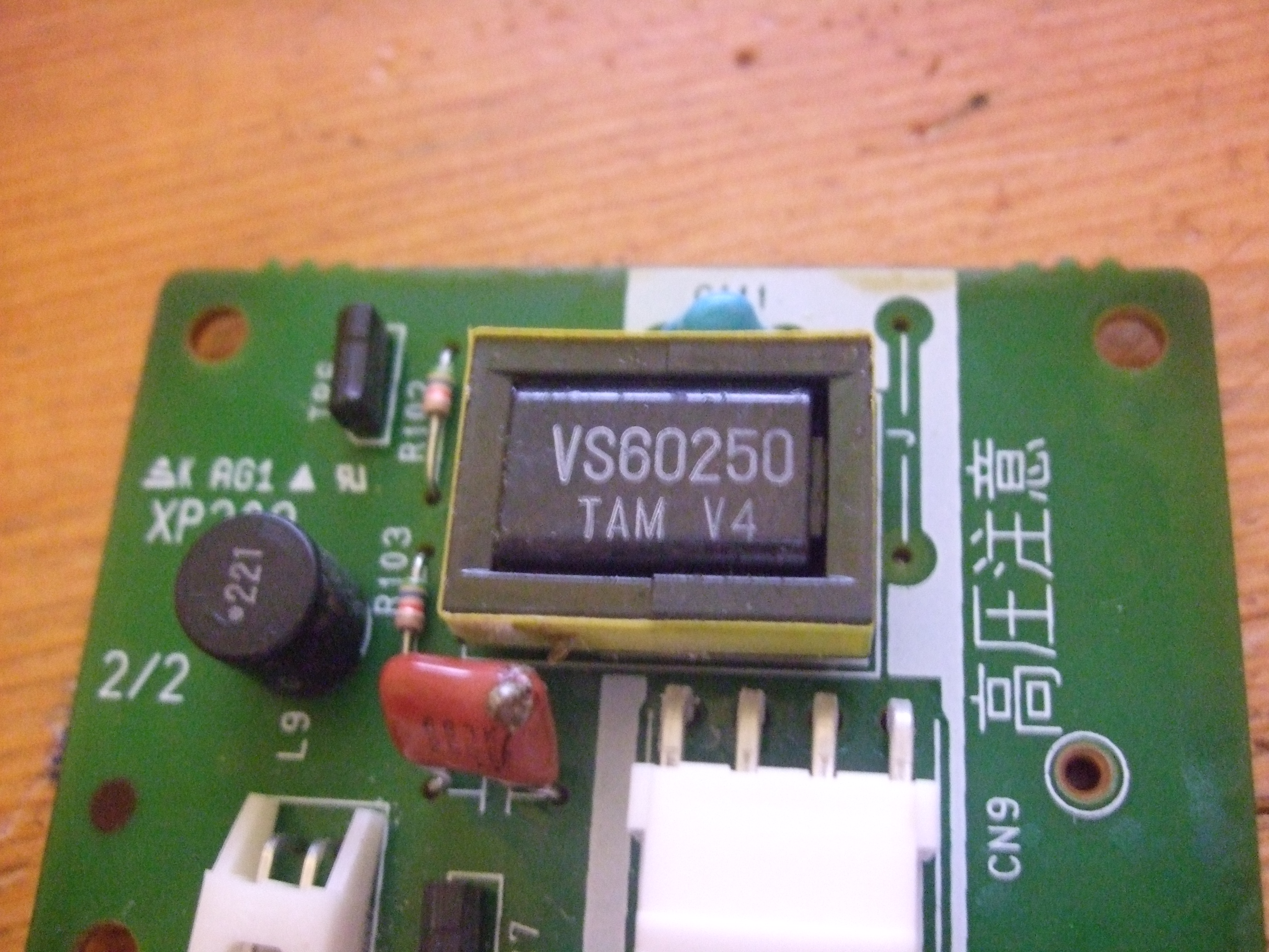

I am a fond piano player and was recently given a Yamaha PSR-6000. it has had a lot of use and during my piano lesson yesterday the screen started flickering and a puff of smoke came out. I immediately turned my piano off and put it outside to cool.
Later that day i decided i was going to take it all apart, so I did. I was expecting it too be something in the power supply, such as an electrolytic cap (suggested by a few people on the chat) but found out it was a mica cap which i shall replace. I am about to swap it with another capacitor but due to my age i do not enjoy working with enclosures that house 230v (my dad is an electrician of some sorts so i am not too bad). I am willing to give my piano another try with the new capacitor but i am worried it may have only been a side problem. One thing i have noticed is this step up board does smell of the smoke that came out during my lesson.
I was hoping to look at all the components on the board to calculate the input voltage but am now finding it too be much harder than i initially thought it would be so i can hopefully test it out on my bench power supply first. I would like help to find if this is possible and am willing to do a schematic if some people can help me on one or two components as i can not find any information on them.

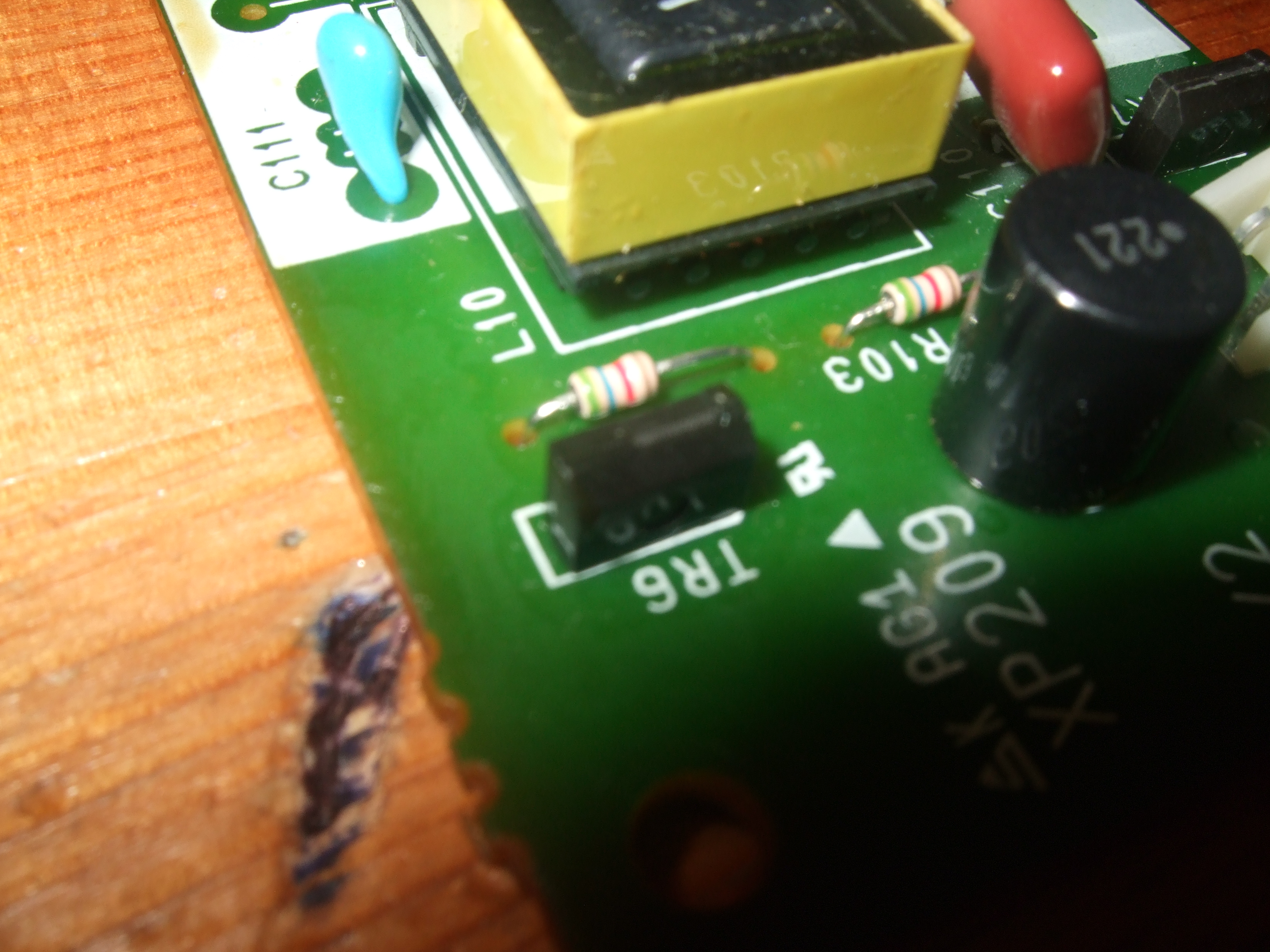

Firstly it is the big component on the board labeled "VS60250". I am thinking it is a coil of some sorts but i would like to know some specific specs on it. It contains 9 pins. The other component i am enquiring about is a component labeled D1863. It contains 3 pins so I am thinking it is a transistor, but cannot find many specfics on it, I found a transistor with a similar number but the packages do not look the same. On the silkscreen it is TR* where * is the component number

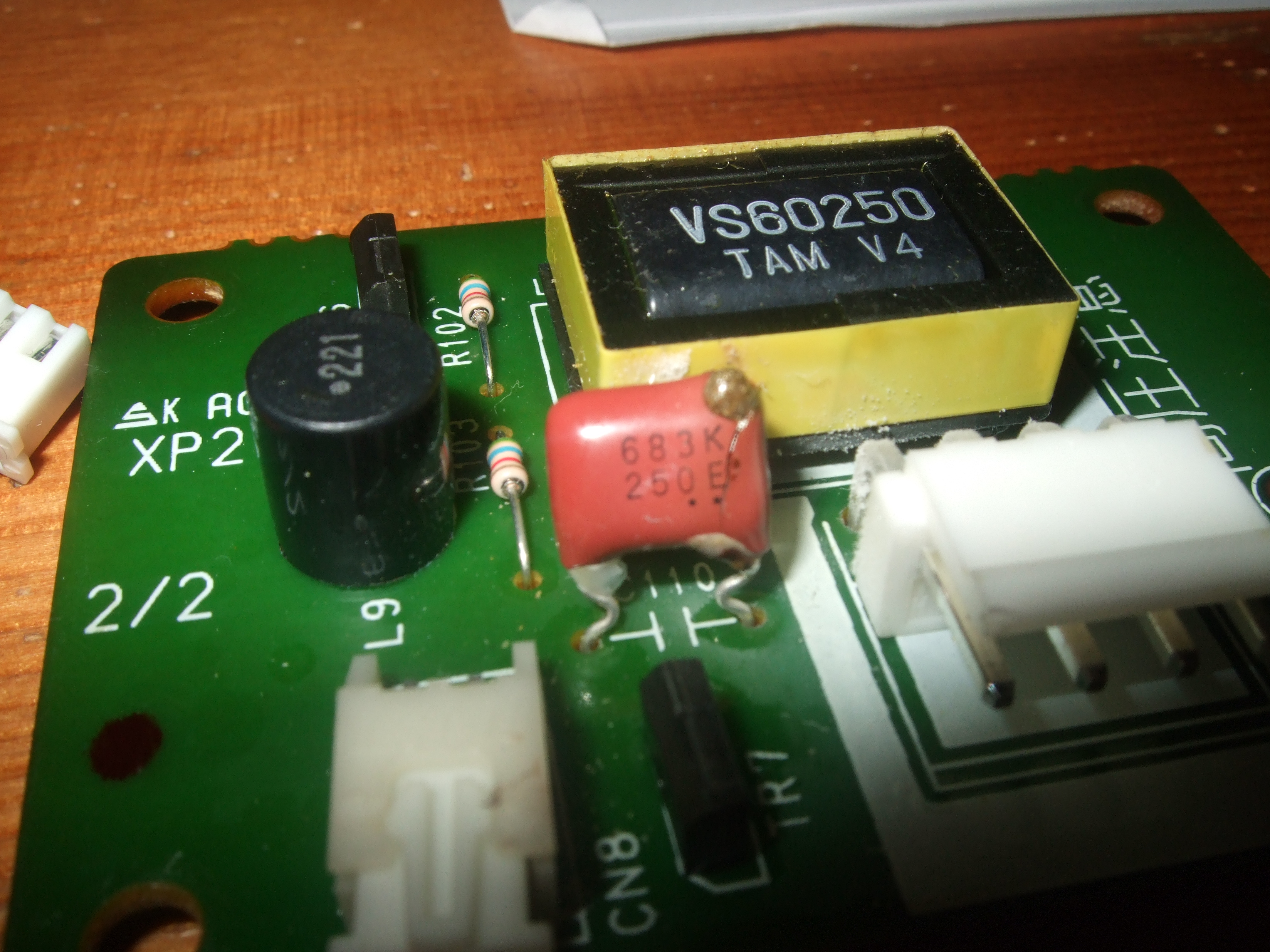

Hi there, nice good clear pics. In the 2nd pic theres a brown cap 683K 250V it has a crack through it, this is posibly where the smoke came from its a 68nf/.086uf 250volt polyester cap. Try replacing this first, the board looks like an inverter for driving the display tube for the screen backlight.
I would agree entirely, the capacitor is 100% faulty, and almost certainly is the only fault - it's a common type of failure.
Does a 250V cap seem low for a 230V mains? Also, could TR6 & 7 be diodes and cause the cap failure?

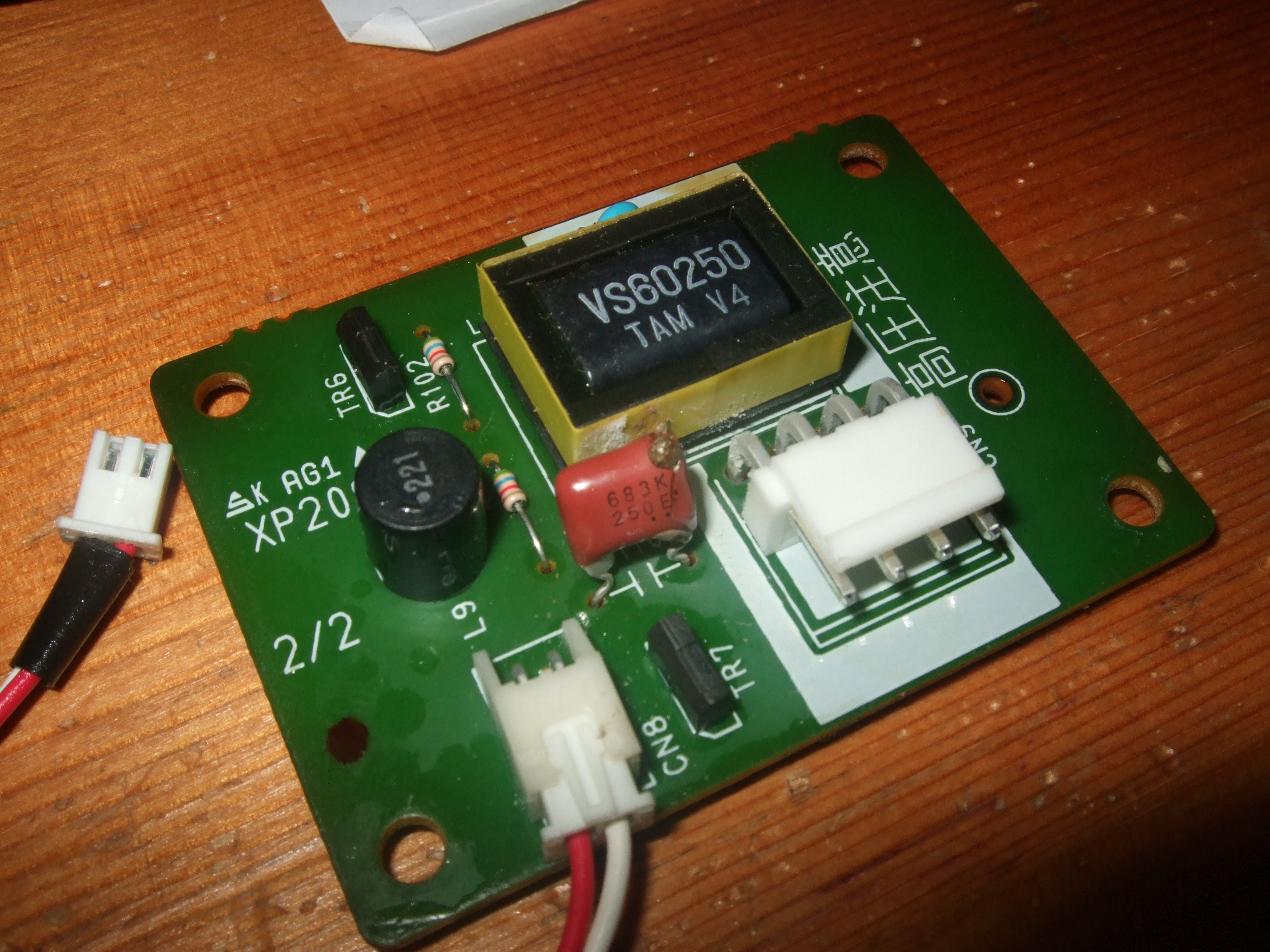

The input is not 230V mains, It is a low voltage input which i feel could be 12v or similar.
Before i commit myself to reassembling the device I wish to test it out of the piano first. This brings me to the question what the input voltage would be, I wish to work it out from creating a schematic from the components on the board. Thank you keepitsimplestupid for the transistor link, I now just need to find the coil specification which is labeled "VS60250",

Personaly I would just replace the condensor & refit the board & tryit, you wont be able to measure the voltage that goes to the tube as its high freq high voltage.

As already mentioned, it's not on the mains - TR6 and 7 are probably transistors - and the capacitor will have failed because it's faulty, nothing will have caused it to fail (except that it's probably not a very high quality cap).
OK just an update I looked at the power supply for the driver and found it too be a 12v output with a fuse at 400ma so I shall be able to test it with my bench power supply.

Sorry for not catching up. I have fixed the device by changing the capacitor. I tested it on the bench succesfully so went ahead to put it all back together. It was a little tricky as i had no service manual but i finally did it with only 5 spare screws. it has worked since with no signs of problems.
Another device that was close to being chucked into the dumpster fixed, alive and well,
