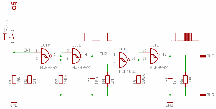

Here is an "AND" composed of two gated oscillator circuits. If EN1 is high both oscillators start working at different frequencies The second ENABLE is controlled by the first output.
The frequency pattern is drawn in the schematic. Frequencies are 290 and 1447Hz.

That will work well and is fine unless you're bothered about the number of pulses per pule.
If you need exactly four pulses then you're stuck because the component tolerances will mean it could be three pulses or five pulses.
Try simulating it again with the some of the resistors out by 5% and some of the capacitors out by 10% and you'll se what I mean.

wow thats impressive man.. I will have to study it for a while to try and understand exactly what its up to

as its a range finder it can just be calibrated to 1 foot = however many pulses?
