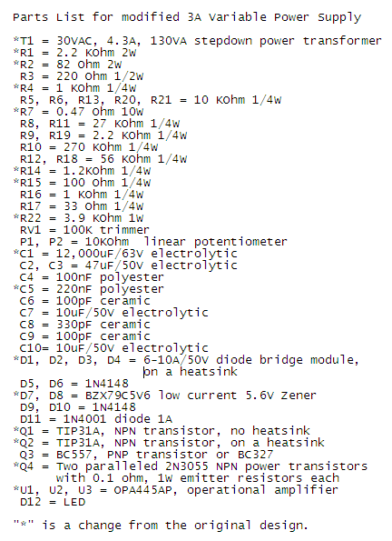

Hi Zach,
That circuit doesn't work. Its tiny rectifier diodes and driver transistor melt at full output and it doesn't provide anywhere near 30V.
Look in that site's forum for a discussion of mods for it to make it work properly. A link to the discussion is at the bottom of the project.
Here are the mods I recommend in its parts list:

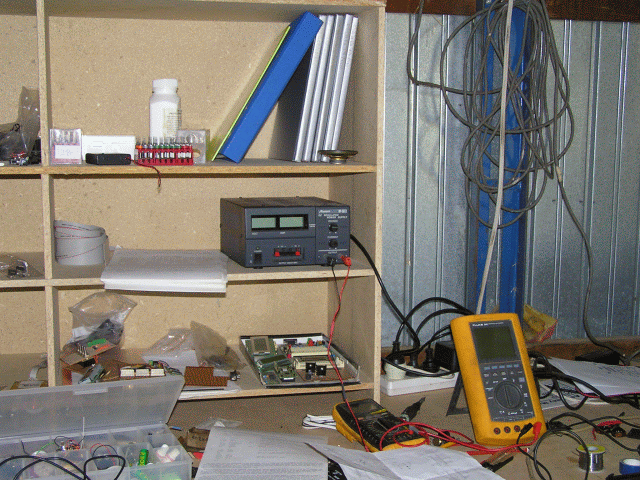

Hiya Zac,
Here's a pic of my PSU, it's a Manson brand rated at 30 volts@ 3amps with current limiting and short circuit protection ( which believe me is a needed feature). I picked it up for $169 Oz and it looked the best buy for the price I could find.
Cheers Bryan :D
I know mine has current limiting. It didn't say short circuit protection, but I'm sure that it does.
BTW, is that a set of carbide drill bits that I see on the top shelf? :lol:
