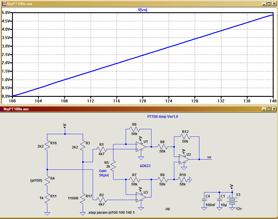

i want to know about PT100 temparature sensor, can i get current output from this sensor 4-20mA. i want to measure temparature 0 to 50 deg C, i want to do this with one ADC and microcontroller

One option would be to make up a quarter bridge, 3 elements using precision resistors and the PT100 as the fourth arm of the bridge.
Use a AD623 OPA amplifier, output to your MCU.

This image shows one option.
Note the 3, OPA's are all in the same AD623, 8 pin DIP package

so output of the opa is connected to MCU using ADC, can i use ADC0804 ADC for this purpose. i am using 8051 microcontroller
The ADC0804 8bit ADC could be used between the OPA output and 8051
