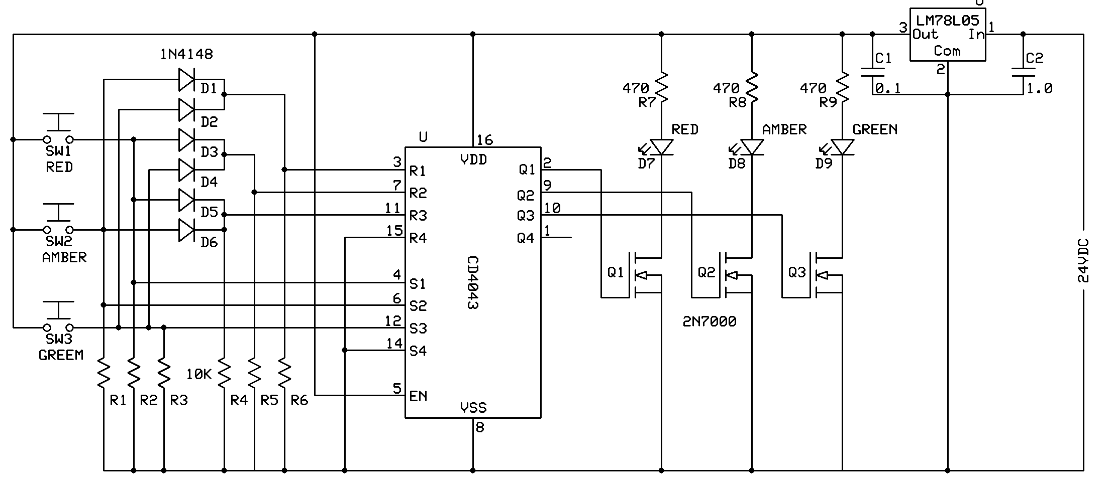

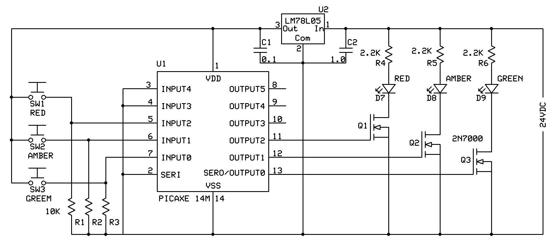

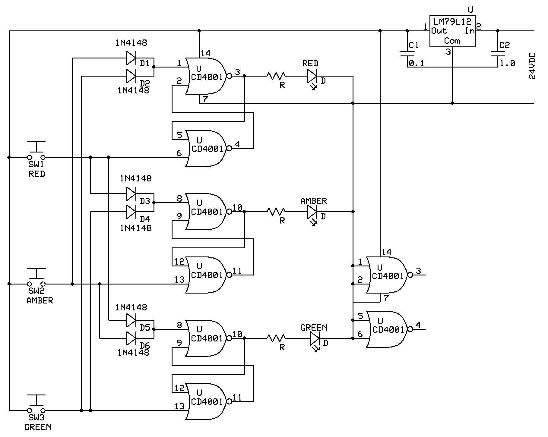

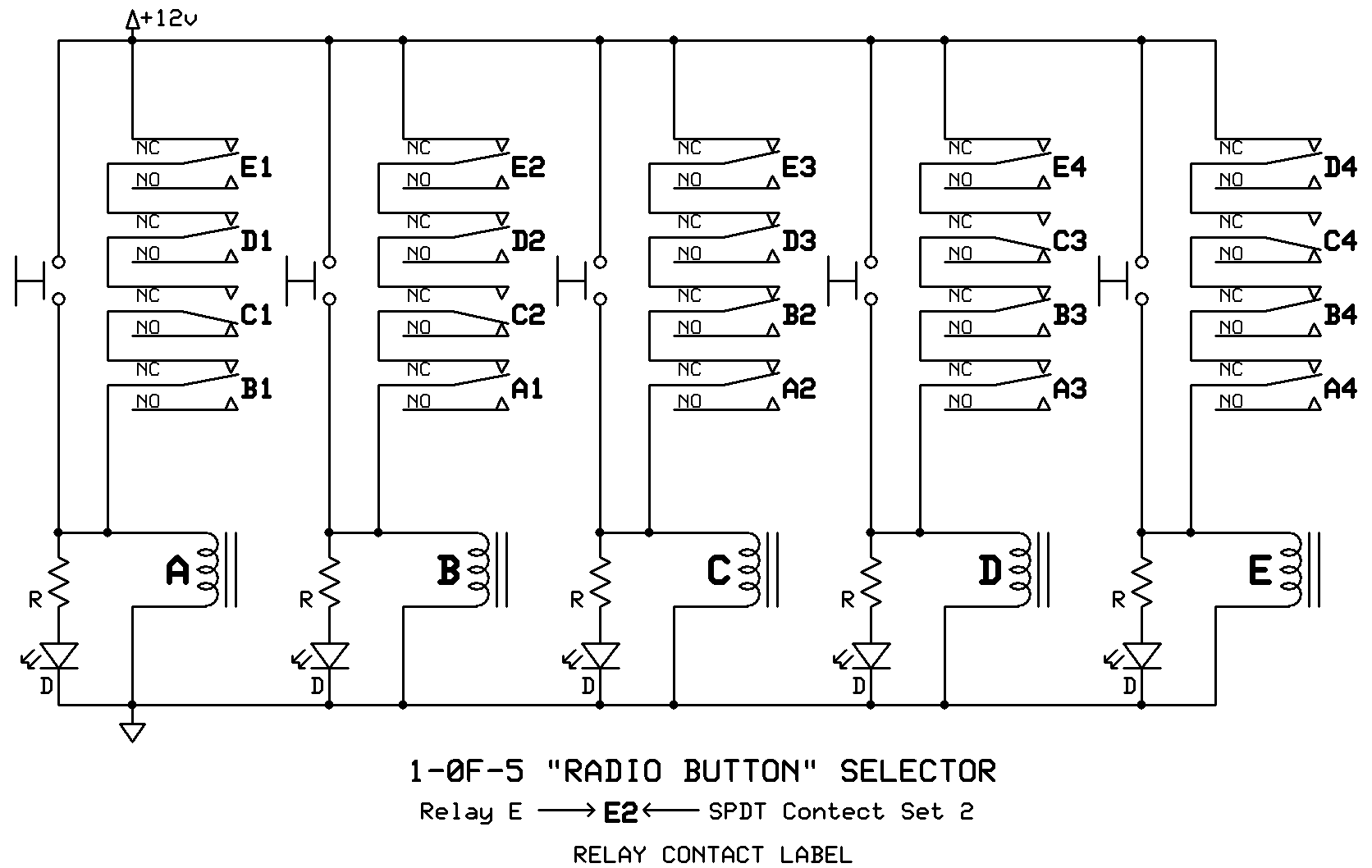

A while back there were a couple of threads looking for 1-of-3 and 1-of-5, sometimes called "radio button", circuits. Here are some circuits that I played around with to that end. These are latching, so push-and-release will maintain the selection. The 1-of-3's can be expanded to 1-of-5's by adding component sets. I'm sure there were other possibilities, but these are what I had on hand to post.
(The program for my PICAXE version is in this Thread: https://www.electro-tech-online.com/threads/24v-flip-flop-help-required.36985/)
Ken

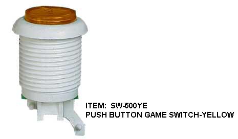

no, i mean if LED#2 is "ON" this will automatic "OFF" if you press Push Button #1 now LED#1 is "ON" so LED#2 is now "OFF"
attached file is the Push button that i want to use.
Thejamesclan's circuit will not work for you. :(
1. If your push button switch has only 2 contacts (I can't tell) it won't work for jamesclan's circuit at all...it requires 3-contact (SPDT) switches.
2. With that circuit, all lights are off with no switch pressed. The correct LED will light as long as the switch is held down. But as soon as you let up on a switch all the LED's are out again. To use your original format for thejamesclan circuit:
