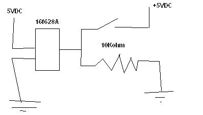

Hello,
I'v installed a switch on one of the pins of my 16F628A micro with 10K pull down resistor (the switch, when activated pulls up)
The thing is that once the pin is high and i turn off the switch, it doesn't seem to get down at all, but it does when i short circuit the resistor
I'm powering the whole thing from the usb port and i'm driving a very small
5VDC relay (maybe some power problem?)
Any ideas? What do you suggest? Thanks

i put a 1k and still, i even tried to use it to pull-up and couldn't
removed the relay and same story
If you're using a PORTB (RBn) pin make sure the internal weak pull-ups are disabled in software.
Which pin are you using? Depending on the PIC, some pins may be TTL-level, CMOS-level, or Schmitt triggers.
Also, make sure you have the pin configured as an input and not an output, and if it's a pin that can be analog (A/D or comparator), that it's set to be digital.
Stick a voltmeter on the pin and make sure the pull-up/down is working correctly. Also, if you can post your code that will help us determine if the pin is configured correctly, the software is reading it correctly, etc.

Thinking about your issue though, it could be that the pin you're using is configured as an output instead of an input.
Which pin are you using for your input? Have you measured the voltage at the pin? Is it behaving the way you expect with the resistors in place?

just measured the voltage and got 5V on the resistor, their might a continuous flow of current because i know that the resistor is not damaged (reminding i'm using a 10K resistor)
Is that with the switch open or closed?
With the switch closed, the voltage on the pin should be 5V (through the switch), and with it open, it should be 0 (through the pull-down resistor). With the switch closed, there will be current flowing from +5V through the switch and resistor to ground (about 500 microamps or 0.5 mA according to Ohm's Law). No current should flow in or out of the pin itself, unless the pin is configured as an output, in which case you'll get lots of current if the switch is closed and the pin is set to low (this is why you should have a resistor on the switch side too, to avoid damaging the PIC due to a coding error). If the internal weak pull-ups are enabled, you'll get a small current flow with the switch open, through the weak pullup and your pulldown, and the voltage on the pin will be somewhere in between 0 and 5V, probably somewhere in that in-between never-neverland.
If the pin is 5V with the switch open, you have the pin configured as an output. Check RB7 in the TRISB register, make sure it's set to 1 to make the pin an input. Use the MPLAB SIM debugger to make sure.
What pin is the serial port on?
you're right it was set as output! How could i've missed that?!

When you read a pin, it reads the current voltage on the pin. If the pin is set to output, it's putting out a voltage, and if you read a pin set as output, it reads the voltage which (normally) is what the PIC is outputting, but if you short the pin to Vdd or ground you're forcing the pin high or low regardless of what it's trying to output, so it'll still appear to work as an input, but you'll be sourcing or sinking a lot of current through that pin, and risking damage to the PIC.
