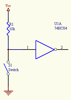

A pull-up resistor works on the fact that when on current flows in a resistor, the voltage drop in a resistor is zero (the voltage at both ends is the same), but when a current does flow through them they allow a voltage drop which lets the two ends of the resistor be different.
See my attached image. Suppose we had an input pin and just connected it to +V through a resistor. So if a resistor runs from +V to a pin (with input current so low we can just assume it is zero), we can say that the pin voltage is equal to +V since the resistor connects them, but no current flows so the voltage is the same at both ends of the resistor.
What happens if we also add a switch to connect the pin to ground? WHen the switch closes the input pin is connected to ground and current suddenly flows through the resistor from +V to ground making a voltage drop of +V in the resistor. So the result is that the input pin voltage is 0V whenever the switch is closed, and whenever the switch is open, no current flows in the resistor so there is no voltage drop and the resistor "pulls" the voltage "up" to +V.

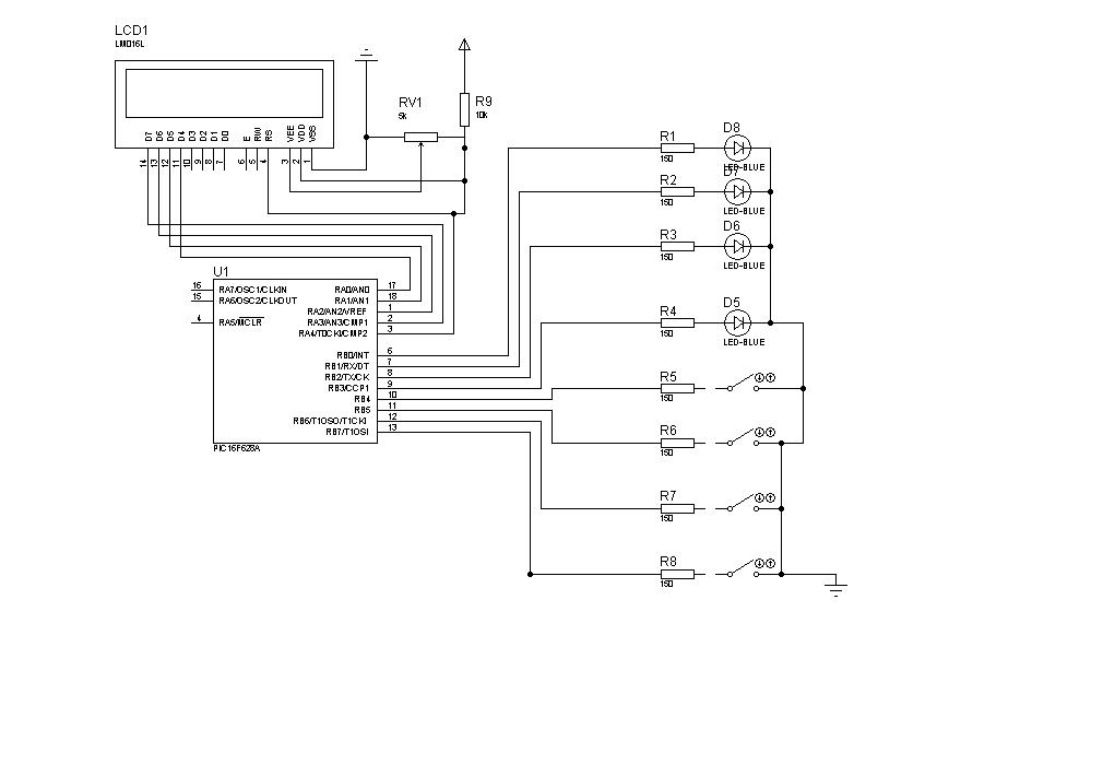

Pull up resistors keep an inactive control line at VCC, they're usually high value resistor mainly to keep input pins from floating. You don't usually use pull up resistors with an LED, please post your schematic from a screen capture of Proteus and explain exactly what you're having trouble understanding.
Thanks dk... thats the concept that i have which is to prevent IC pins from floating.What about the pull up resistor on RA4 of Nigel's LCD tutorial.It doesnt let the IC have any control and never goes high.

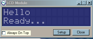

That resistor 10K, on RA4 is correct.
Whats not working on this tutorial.? I could run it in Oshonsoft Sim.
Im sure the program should run correctly.:)
Ran OK in Oshonsoft Sim.:)

Your schematic looks a little strange:
Why is Vdd and RS of the LCD connected to RA4 of the PIC?
The pullups, R5-R8 don't appear to be wired right. They should be around 10K. Not 150Ω.
MCLR of the PIC is floating.
E & RW of the LCD are floating.
The contrast POT for the LCD appears to be wired wrong. It is hard to see the model number of the LCD to be sure on this.

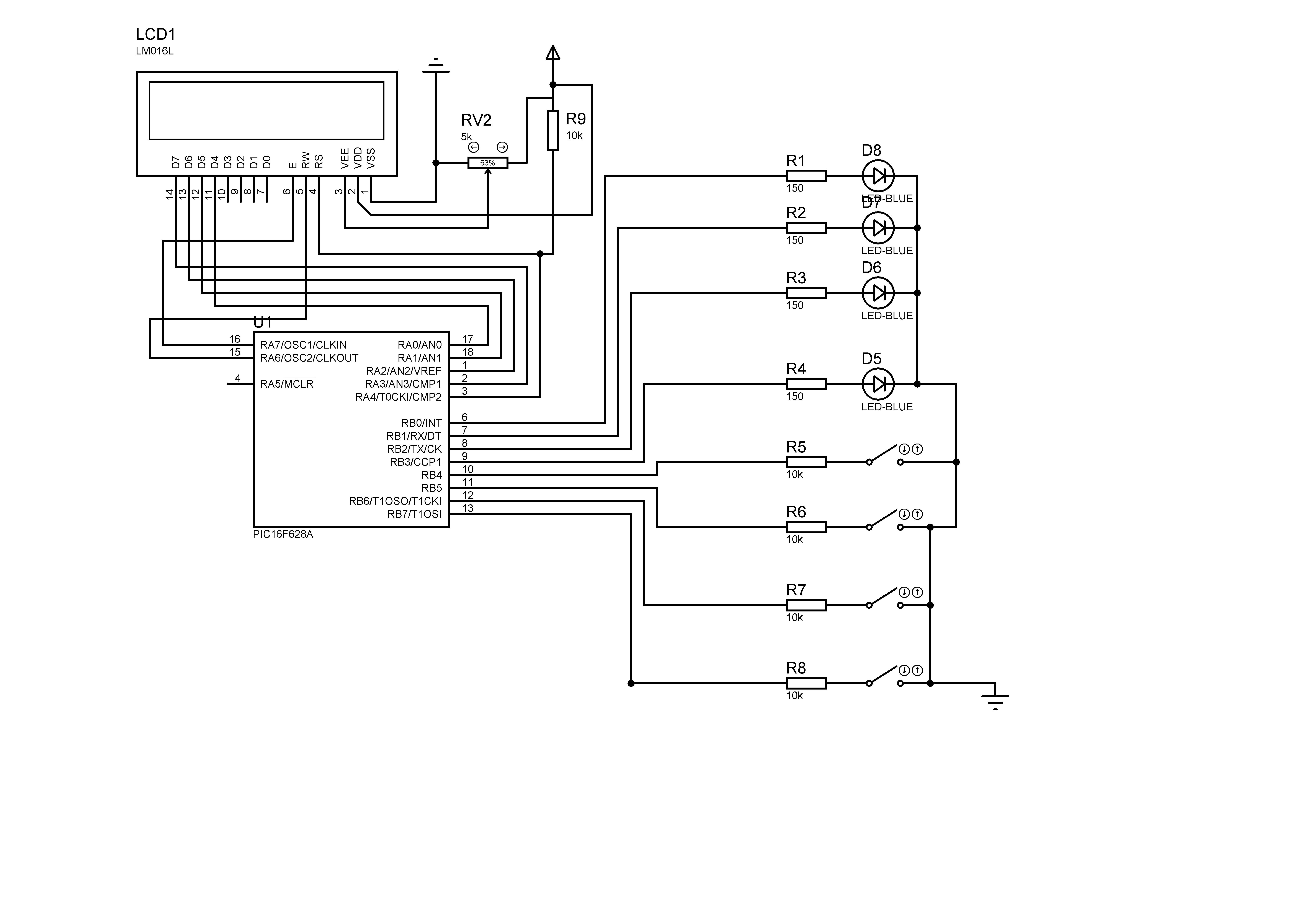

Hi missed conenctions there.Now i have made all the encessary connections. The LCD still does not display any thing.I am uploading the picture,the file and asm file from Nigel's tutorial.

Is the PIC set have 'weak' pullups? if not the switch/resistor wiring looks wrong.
Hi Thanks for your reply. The switch/resistor wiring was same in the previous tutorial altough they were connected to PORTA and the resistor value was less.I decreased the resistance value for the LED to get more brightness.In the program that i uploaded i-e LCD Tutorial 1 the SW/R combination is not used.I am working on teh Oshonsoft simulation though but wanted to know why is it not working in proteus.The pull up on RA4 keeps it as high all the time.
