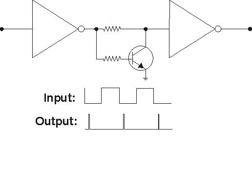

How about using a couple inverter gates and a transistor? You can get pulse widths of just a few nanoseconds (not necessarily 10% duty) quite easily this way. If you want adjustability, the easiest way is probably with the 555.

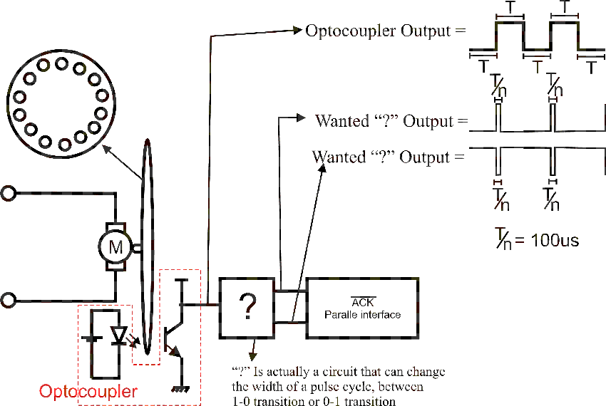

complete problem
in this reply, i added an attachment of the block diagram/schematic...
hope that'll helps

problem design
Nigel Goodwin:
The pulse width is actually to speed up the respon of the holes of the disc, that's why i have to change the pulses from the optocoupler.
To change it to down pulses, an inverter could done it, isn't it?
By the way... thank's for the link that you provided, it's a good reference....

An example of how an inverter can be used to shape your pulse is above, in my previous post.

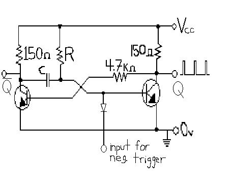

If you want to use a discrete monostable multivibrator ("one-shot") circuit as shown below, use t=CRln2 to set the duration (t) of your pulse.
Its simpler (and way more stable) to use a 555, and simpler still to use a PIC.

In your previus post (pulse.jpg), how can i determine the value of the components (resistor) ? And what type of transistor would be used?
Also in your newly post (monostable.jpg) what kind of transistor(s) is used?
what's the difference between both configuration?

Nigel Goodwin :
The goal of my project?
Just like the block diagram in my previous post, i want to build a rpm counter that will be interfaced to pc using parallel connection. The rpm will be displayed at the pc's monitor.
The main purpose of my project is the implementation of interrupts from a rpm counter module to the pc.
What i needed now is a circuit design that can change the output pulse from the optocoupler (IR receiver) (just like in my previous post iwa2.jpg), since the original output pulse had 50% duty cycle.
And then the output'ed pulse will be directed to ACK pin of parallel connections.
Thank' s.

Nigel Goodwin :
That's the problem.... it has been specified in my project that i must altered the pulse width to fullfill the interrups requirements, so the pulse will be 100us.
