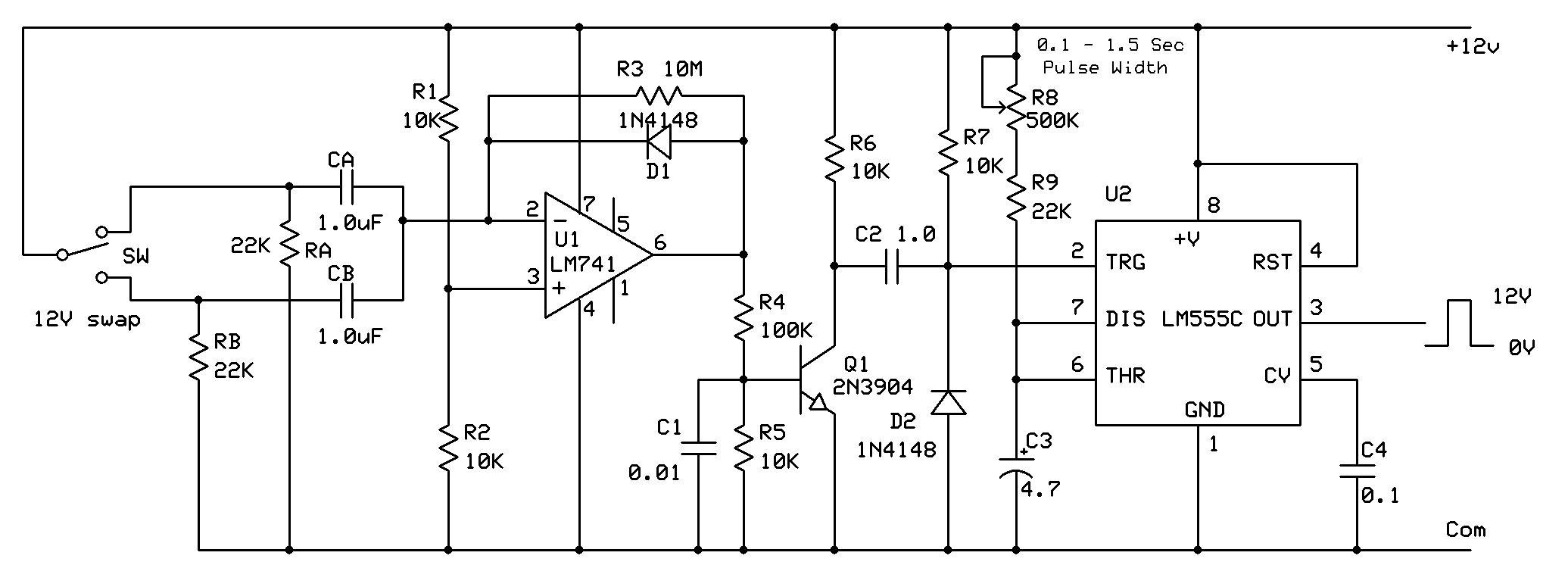

I need a 12 pulse every time 12v comes on,
for a friends car im looking at,
when you unlock the cars 12 volts stay on and when you lock the car the 12 volts swap over to the lock wire, now i need a pulse each time the power swaps over, i have looked into the 555 timer but i cant work out how to get a pulse, I am using a program "ciruit wizard"
any help would be great.
planty,
Attached is a circuit that I helped a student with, to detect the daily activity of 3mm blind cave fish. The input has been modified to detect positive going 12v levels...as in your lock system. I think this will do it.
Ken

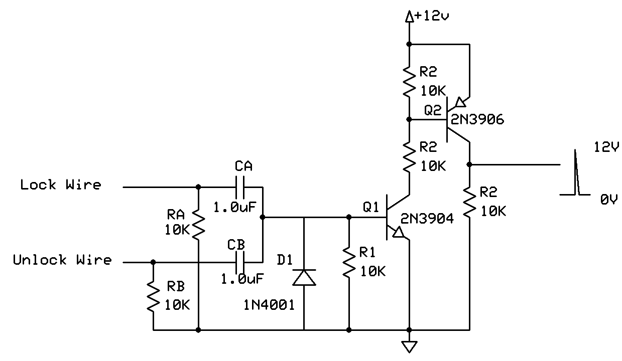

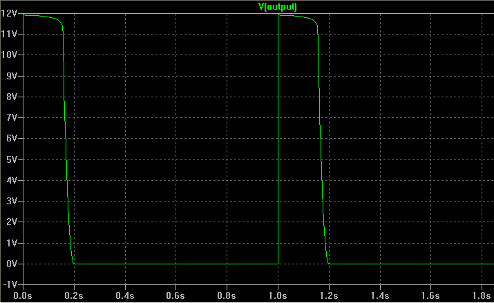

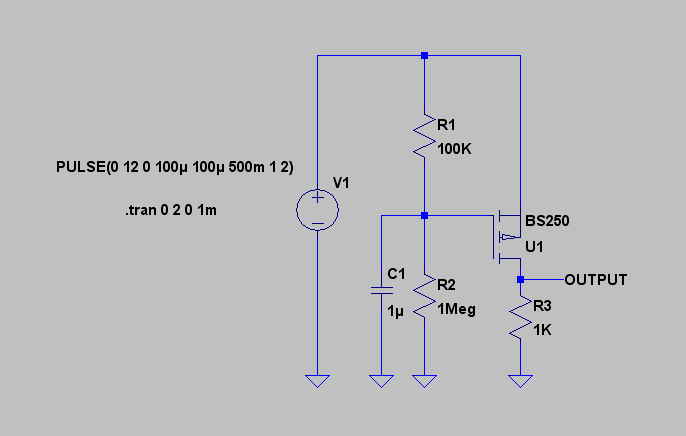

Hi Planty,
Is this simple enough ?
on1aag.

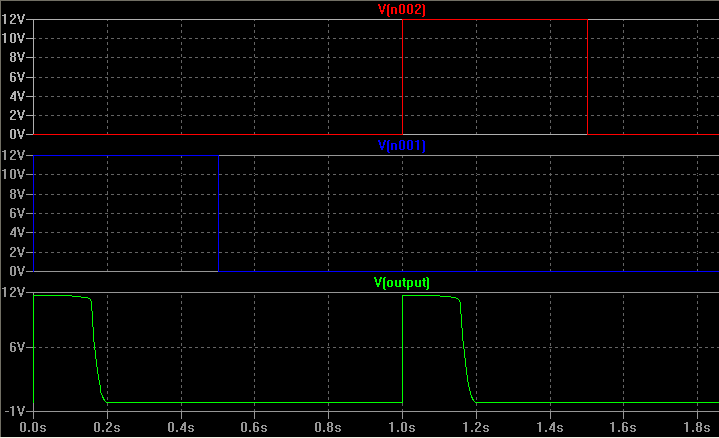

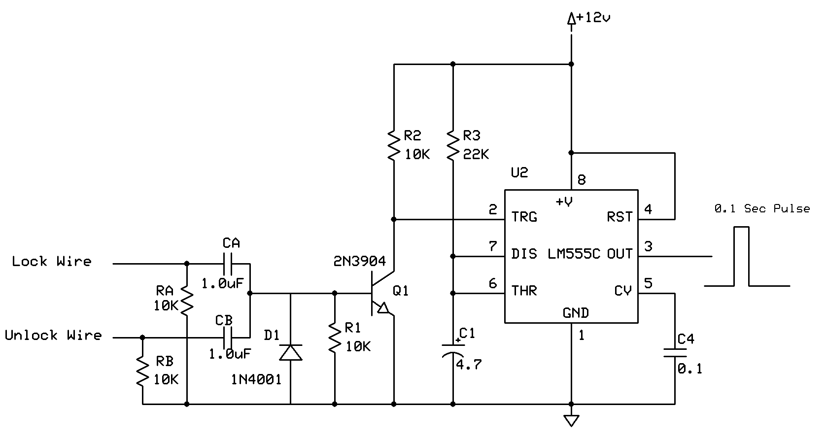

OK...a little less complicated. RA and CA can be paralleled with as many lock/unlock inputs (RB/CB, RC/CC....RX/CX) as needed. Whenever one lock/unlock changes there is a fixed width pulse out of the 555. Or, if you don't care about the output pulse width...there is one without the 555 monostable.
Ken

That look easy ish, but what is that 2n3904 - Q1 thing?
on1agg,
Could you complete your schematic with two inputs, one from a 12v locK wire and one from a 12V unlock wire, as in planty's original description. Lock is always high or unlock is always high, and with positive output pulse as in your signal display for the "change over". I might be just missing something in your approach.

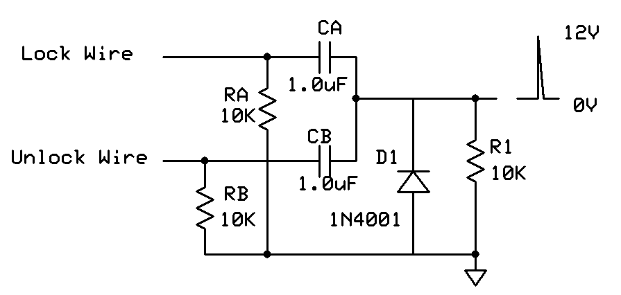

And not knowing what you are going to do with the 12v pulse...one more with even less.
Ken

just made this up and no power goes past the resistors or the capacitors
try the other one now

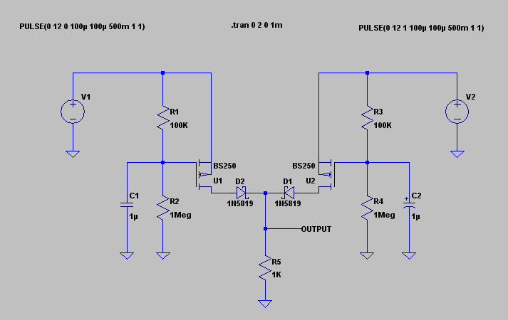

Hi Planty,
O.K. now it's stereo !
on1aag.

well this one works now. it help if i put power to no.4, i think i need a bit longer time on the pulse. i will have a play,
on1aag said:
Hi Planty,
on1aag.
well tried this one, and instead of a pulse it puts out 7.3 volts all the time,

When you say you need a bit longer time on the pulse...what do you mean...?
It really simplifies things if you can tell all of us what you need...from the start. You never said what you where you were going to do with "a" pulse...just that you wanted one.
The devil is in the details.
Ken
I wouldn't bet any money on it ! :D
on1aag.
