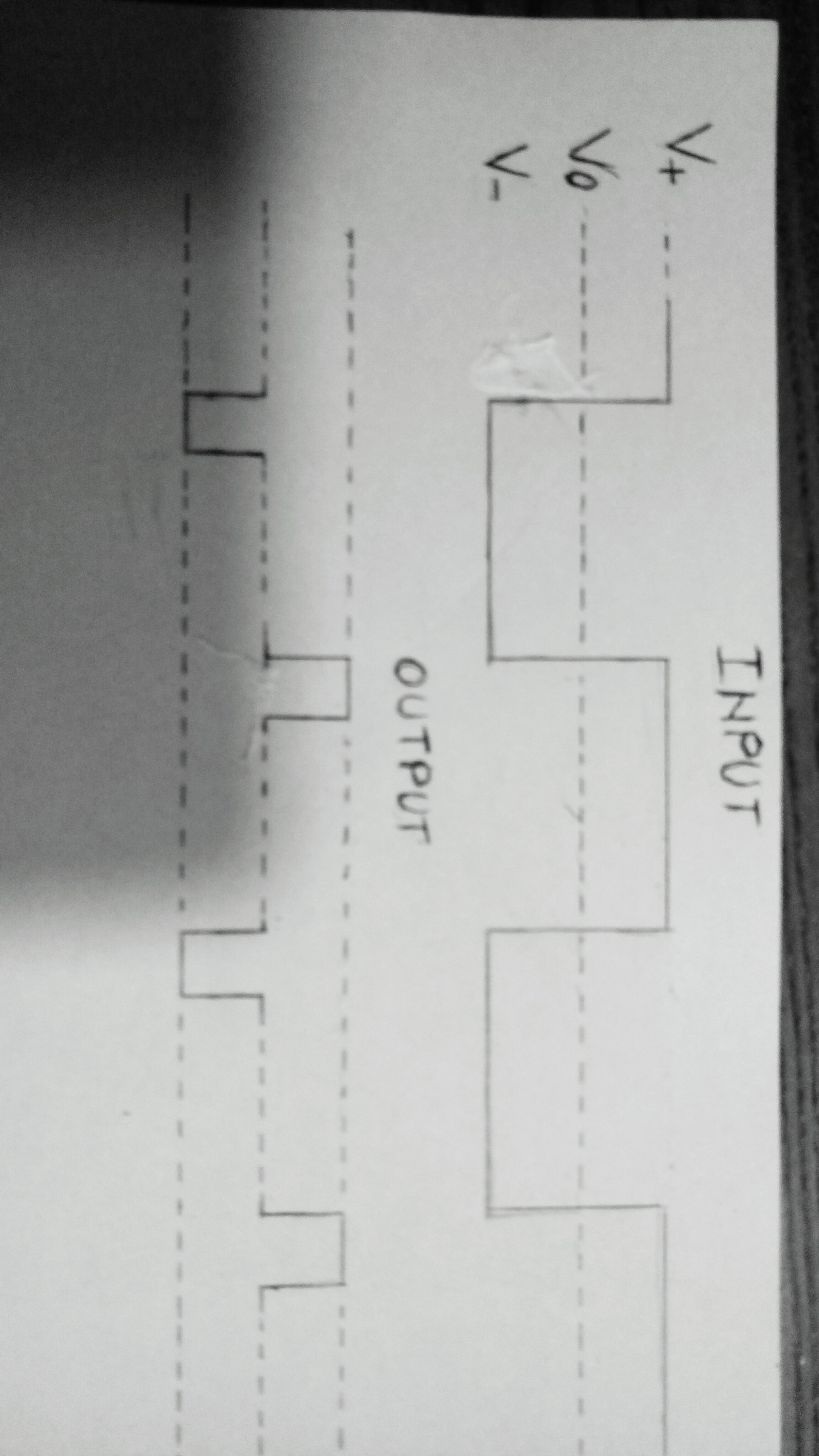

Hi.
can you help me? .
how many ways are there to get what I drew in the attached file?. I prefer not to use micro.
there is no frequency. I had to draw a frequency to make people understand.
dual input voltage and dual pulse output voltage.
bye thank you .

Wat is the magnitude (voltage) of the input pulse?
What are the pulse width and magnitude requirements of the output pulse?

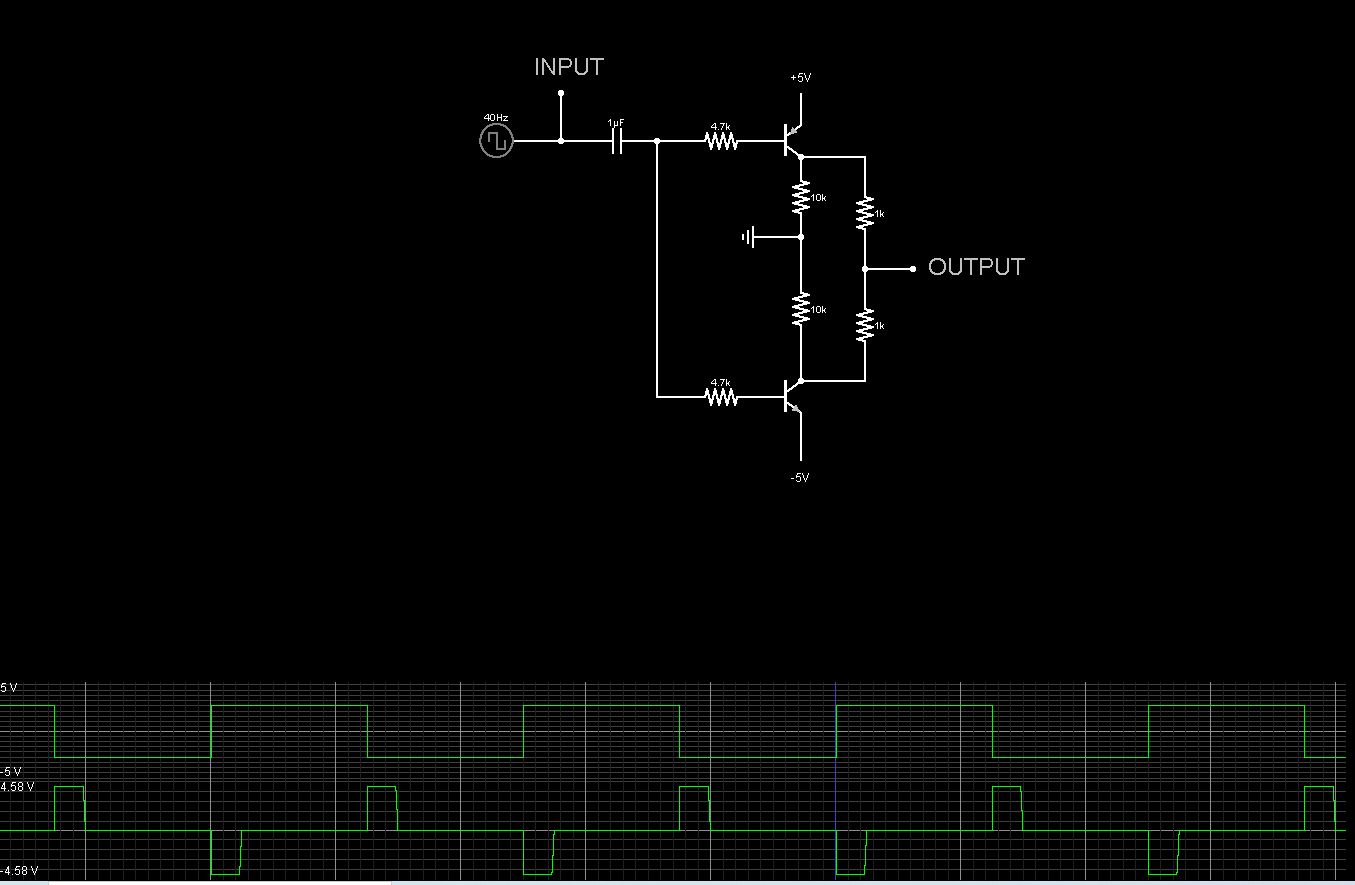

For a low current solution you could 'almost' get there with a handful of discrete components. I say almost, because the output is inverted which is a simple fix... just invert the input. If you want more output current there are ways to do that but would involve a few more transistors on the output stage.
In addition to what Chris said, we need to know the output current. More details.
I have not specified because I have not yet chosen a fixed voltage. I can however say that I will choose a voltage within the range from + 5-5 to + 7.5-7.5
output pulse voltage as similar as possible to the input one.
I have yet to establish the duration of the impulse, but more or less it will be about ten milliseconds
What is the purpose of the circuit? What is the output pulse train connected to? Depending on what you really need, this might be possible with nothing more than 1 capacitor and 1 resistor. Or maybe add two zener diodes to set the output level.

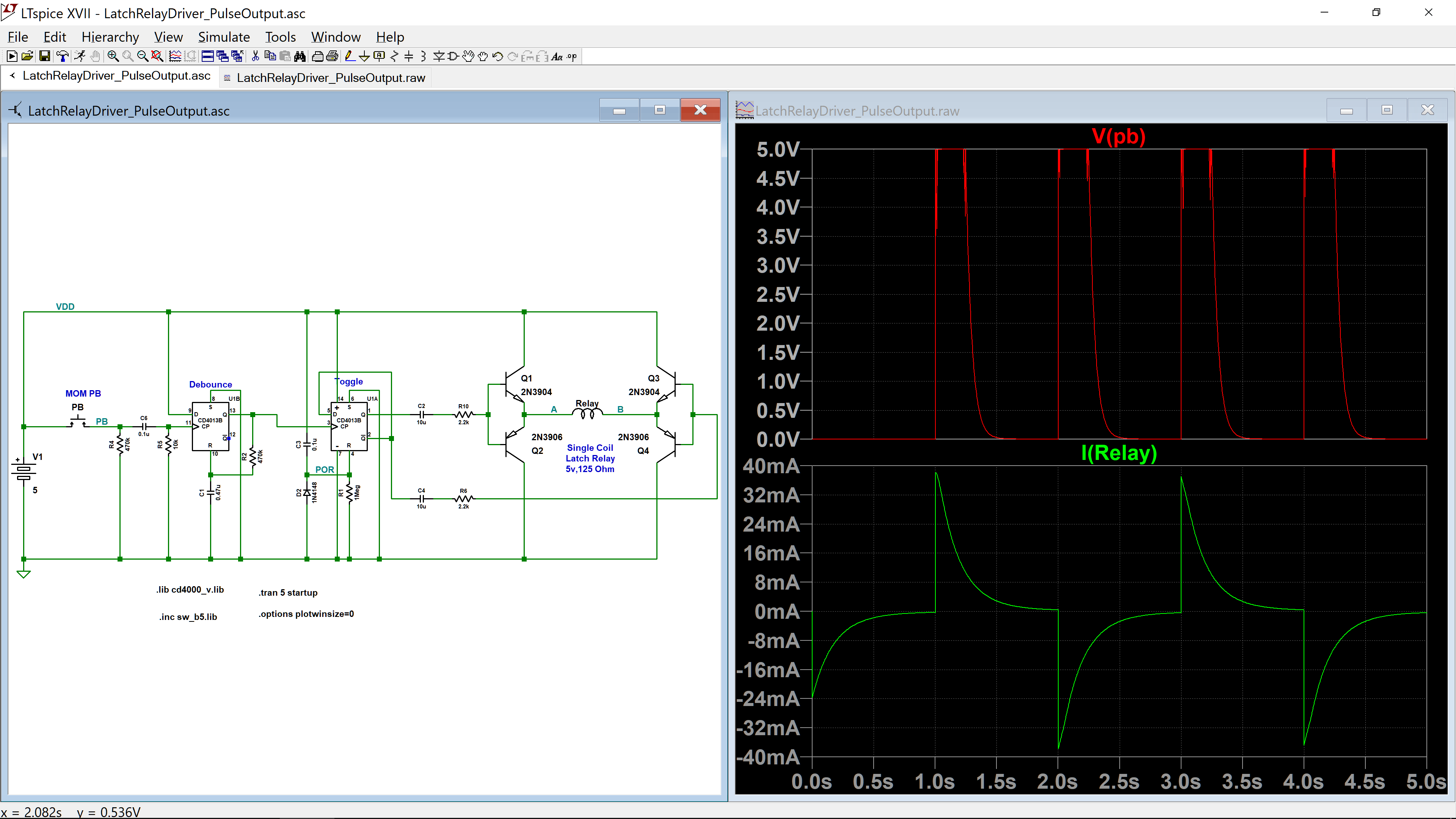

Here's a single coil latch relay driver that should work (i haven't breadboard tested it).
The relay is driven from the same supply but it can be a different supply if needed.
Pulse width is determined by C2 and C4. 10u should provide about 10ms on time at 40mA for the relay shown.
It requires 1 CD4013B chip.
