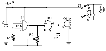

Does this look like it could be what I am looking for? I know I would have to change out some parts to get the power output I am looking for.
My next question would be, Can a trigger switch like from a codless drill take the place of the potentiometer?

If it is a variable switch, then it is a potentiometer.
You will have to see what the range is on the drill-switch to see if the resistance range matches or atleast covers what you need.
You can go to Radio Shack and get yourself a few POTs for a dollar or two.
