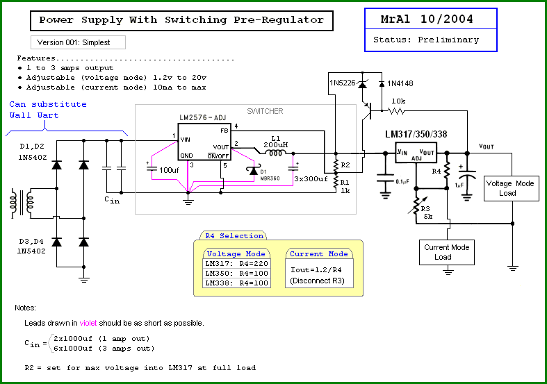

The simplest way to get differential feedback is with a transistor and zener, and coincidentally it's also the fastest. Perfect voltage regulation here isnt mandatory because it's only keeping track of the voltage across the linear regulator.

Wondering if you might give me some insight as to how to apply the transistor and zener on the linear reg... I assume it goes on the middle leg and is a function of the input voltage... not sure though.
by the way for the linear regulator I was intending to use the LT1083... I was going to use two of them in parallel.

Here is the basic connection diagram. People have built this circuit quite a while back and we even had a Digikey web project for the parts but it's probably not there anymore.
