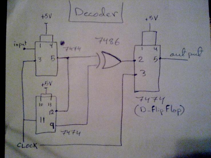

Hi everyone,
These modules usually require encoding of the transmitted signal, and if you need a low error rate you'll have to send the signal digitally with error detection/correction.
Right now I tried to encode the data using a 1-bit differential ecoder and then I directly applied it to the corresponding decoder.I could say the process was a success, but I obtained exactly DOUBLE the original value of the pulse width, that is, the result was 84 but without the 1-bit differential codec it was 42!!!
Now I could simply divide by two in the microcontroller program, but, what's the cause of this?
I'll attach schematics of the 1-bit differential codec that I used down below
thx in advance.

Last time I tried to encode the data before transmitting it and the result was successful, I was able to distinguish between 3 different signals by reading the width of their pulse: 1KHz, 1.5 KHz, and 3 KHz.
Now the next thing that I'm working on is establishing communication between two microcontrollers where one of them will create a variable the value of which will indicate the time that the signal travelled.
I'm gonna try this out (I've never done this before) but I want your opinion:
- Is it possible and Has it been done before on a small scale?
thx in advance
