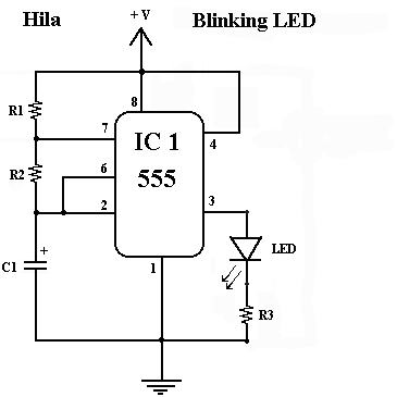

I would like to build a circuit what is pulsing one or more led.
How it is possible? What should i use? ICs, condenzators or transistors?
So i need some helpful message to do it...
Nothing extras just a little circuit
Thanks in advance!!!
This'll work.
Thx, but i want to pulse it, so decrease and increase its brightness.
Like the pulsing neon under the cars in NFS: Underground...
ThX in advance!
There used to be an IC that did this nicely and provided a little more visibility by means of a short duration but higher than normal supply voltage. I googled on LM3909 and found some info on it. One site described a discrete component replacement.
so you want the LEDs to fade on and off?
It would take some experimentation to get the right values and what not, but try putting a resistor and capacitor from pin 3 to ground in that order. The idea being that the when pin 3 goes high, the capacitor sucks current, not letting all of it go through the LED. When pin 3 goes low, the capacitor drains through the LED.
I'd start out with a resistance of 1k and 100uf, but that is a total guess, if anyone wants to do the math be my guest, im too lazy :lol:
