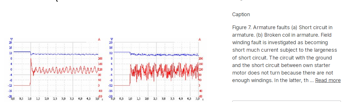

The contact resistance between the brushes and the commutator will not be constant. The movement when the motor runs can result in completely different effects than what happens when a low-current source in a multimeter is used.
As from back in post #2, a multimeter is no good for attempting such measurements as this.
With 0.1 Ohm resolution as stated in #4 the probe resistance can be subtracted from the lowest static armature reading. It will change with rotation angle.
There is no reason given for this type of DMM reading to be "no good" to read a 1 Ohm range result.
But it is possible there is an armature commutation short.
