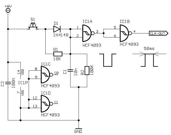

Hi guys,
The 4017 circuit was ok,ish but as you say the deboucer circuit was just not solid enough the diagram I followed can be seen here,
Handy dandy little circuit #34
but then when I took the push button out and connected it the servo switch, it turned out to be more like a random number generator, with just pot luck on which output circuit was going to energise.
As for the output circuits, then linked out with the OR gates as mentioned,
So shall I stick with the 4017 and hope you guys can help me with debouncer problem or try start again with a shift register.
Somebody has mention a 7474, but I couldn't make head or tail of that, and not even find a tidy circuit diagram for what I want it to do.
Thanks so far guys.
use a schmitt trigger before the input and it will work fine not to respond to any noises. you can use RC filter and trigger the schimitt trigger that will give pulse input to 4017. (monostable)
on the debouncing circuit you posted, still there is a way to improve, use a series resistor after the switch to give the voltage to base and increase the capacitor value depends on the ON time you get from servo switch.
Hi jo,
you might try out this circuit. It puts out a clean 50ms square wave pulse.
Boncuk

jo,
Can you post a schematic of exactly what you have? Any idea what the output of the servo switch looks like? Do you have access to an oscilloscope?
Ken
