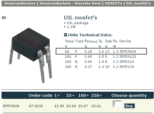

Just out of interest, what kind of voltage drop are you getting across that fet in the supply line? ( ie, what fet did you use? )
I'm currently designing something similar with a 'soft' on/off, but all I am doing is using an interrupt - my application shuts down into ultra low power consumption when in-active, but of course that doesn't suit every application.
I have just measured it to be 120mV.
The P-MOSFET is BS208 and the N is BS170, supplying a 16F876 running at 11.0592MHz flashing two LEDs.
Interesting, the spec sheet for that P type fet suggests an Rds of about 7 ohms.
I guess you must be consuming about 20mA? My problem is that I have peak currents of around 300mA, which would produce an unacceptable drop between drain and source. Ho hum!
The design places no restriction on what P-Ch MOSFET to be used, as long as its gate works with logic voltage level.
I'm not sure whether you can get one with low enough Ron that also works with logic gate voltage level.

Search the Net for those modern P-Ch MOSFETs, they are logic level and have very very low Ron. See an example below.
I am sure other forum members can recommend several part numbers to you too.

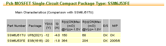

My original searches found that low Rds fets are either hard to get or expensive - in the end, for my app, putting the attached devices into low power mode and the pic into sleep was the best solution. The total consumption is so low I'm finding that the self discharge characteristics of the battery is more important than the standby power consumption!
The NanoWatt PIC's are great devices :eek:)
Hi gentlemen,
There might be other things on the supply rail which one can't put to sleep. I thought the 11.0592MHz crystal frequency would give it away.
Let's start first by putting my MAX232 to sleep. :shock:
MikeHibbett said:
My original searches found that low Rds fets are either hard to get or expensive...
The following MOSFET is from Rapid Electronic UK, reasonably priced. The voltage drop at 0.3A is around 120~150mV with -4.9V Vgs from manufacturer datasheet.
