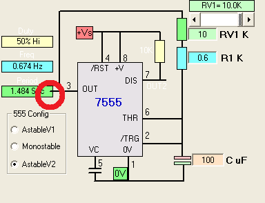

Also, using your diagram I have worked out the resistors and caps I need. Is it right that the period will be the same for both on and off cycles? Also is it correct that the output is on pin 3 like I have circled in my attachment?

Using that configuration for the 555 will give a 1:1 mark/space ratio output on pin 3.
Connect a 470R from pin3 to the Gate of the IRL540.
Operate the 555 from at least a 5Vsupply in order to ensure a satisfactory Vgs turn on voltage, you could use the available 12V for the 555, ensure there is
good decoupling on the 12V line, say a 220uF or higher and a 100nF cap. [1N4001 suppression diode across the solenoid coil]
