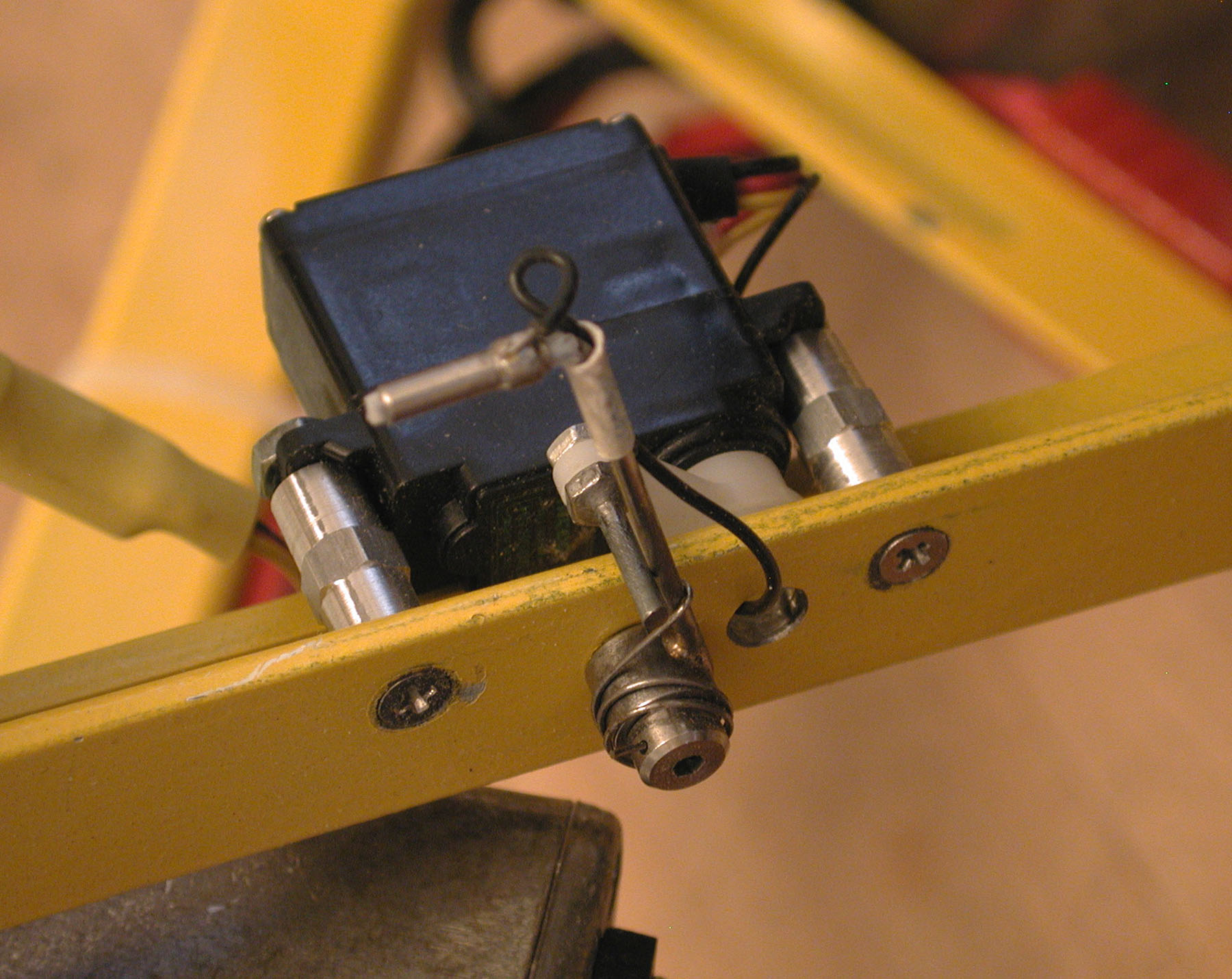

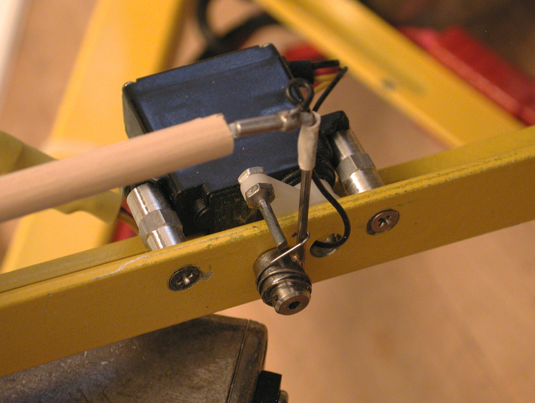

We have all seen comic pictures of the robot trying to pick up a soft object, with the end result being it it squeezed to pieces. Servos go to a position, and if that position is just a little past where it should be, say because of temp drift of the amplifier, the servo will exert its full force to try to get there.
Attached are some pictures of a application where the servo moved a lever. The "up" position was not critical. The down position was spring loaded, like I would imagine your valve covers to be. It used minimal machining. I simply brazed a wire to a bushing that ran on a shoulder screw. Everything could be bought off the shelf, except, to save cost, I did turn the bushing myself.
A second suggestion has to do with mounting the servos. I assume there are about 6 holes in a recorder (never played any wind instrument), which means 6 servos. The cheapest hobby servos need to be mounted on rails, and if you refer to the geometry needed for the levers, that might be a little complicated for 6 servos. Servos are also made with the mounting lugs at 90° to what you see in common ones. They are often called "wing servos," and they are mounted on the flat side. Another option is simply to roughen the surface on the flat side and use an adhesive. I have had poor luck with double-stick tape, but have had good luck with hot-melt glue and two-part flexible adhesives. You can also use heat-shrink around a mounting board. Anyway, I think that mounting on the flat side would allow all servos to be mounted on a single board or metal plate.
Sorry for the length of these comment. John
