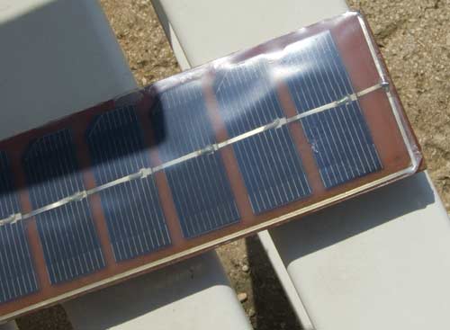

ok well they are old cells and as it is covered in glue/silicone I suppose that don't help does it ? perhaps I'd better try to peal it off, it looks like a strip of circuit board with the elements (8) stuck to it and they are connected in series to make up 4 volts

I would hope that the manufacture wouldn't put a plastic that obviously reduced power over the top of a cell, but seeing as how the plastic is visibly opaque it wouldn't hurt to rip it off and try a sheet of glass over the top instead. You're only going to add a few percent to the efficiency of the cells though, it might not be worth it, especially if your glass doesn't adequately protect the cells.
well on top of that glue there was a plastic cover I have already removed but it had gone yellowy (20 odd years old) and was knoking out 30 % of efficienzy.
I'm considering dismantling them and perhaps rearranging them, how delicate are those elements ?
Don't flex them. Bending or twisting them will break them easily. They're resistant to shock and pressure so long as it's not enough to crush the basic materials.

I think he just mean that it'd lost 30% of it's output due to the plastic yellowing.
precisely on removing the old plastic it went from 60-70 mA to 100-110 mA
