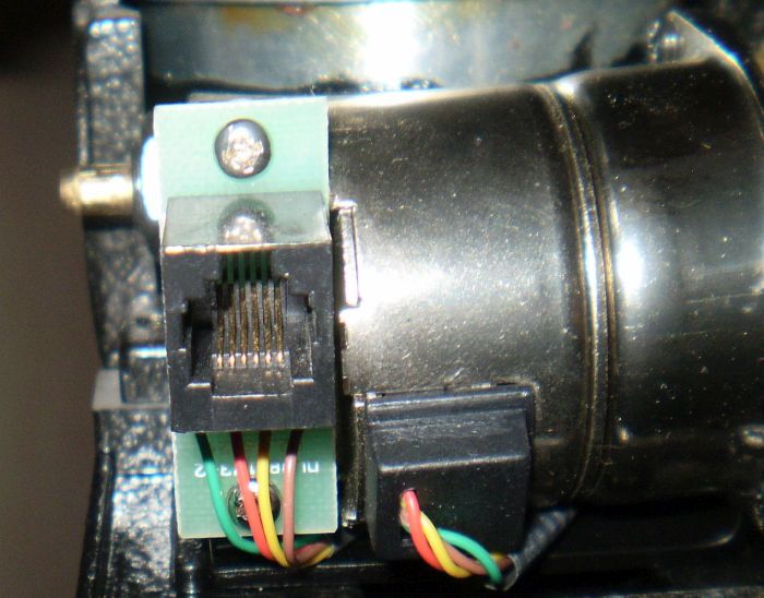

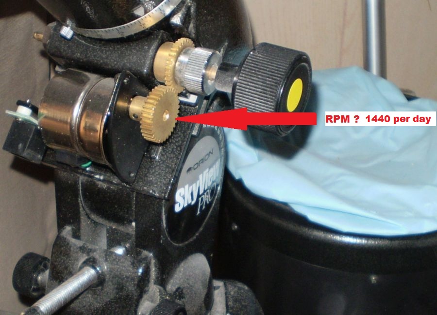

I have an older 8" orion telescope that only has a polar (right ascension) drive on the mount. It lost its control box somewhere between yard sales. I was told it has a 6v servo motor that needs that box with some controls. I don't know where to get them or how to properly assemble them. I've attached some pics which may be helpful. Best2u and thanks

It may be a stepper motor. I would check the resistance between each of the wires. If there are two pairs of wires with the same resistance between each pair, and no continuity between pairs, it would most likely be a stepper motor. It's quite possible that only 4 connections of the 6 way connector are used.
From what I can find, they are a small bipolar stepper, as Diver says.

Interestingly, 1440 revs per day is 1 rev per minute so it will rotate at the same speed as the second finger on a clock. So if the motor is 200 steps (standard stepper motor) then you'll need a step every 300mS.
I could get the control box from the company if they didn't have such poor business practices. All I really need is a motor that turns at 1/10th RPM. Anyone know where I can get that ?
I believe you need the proper variable speed control system, as according to the manual for the motor drive, that becomes the only way of rotating the mount?
(The manual knob is not supposed to be refitted).
In general, a motor geared down enough to turn smoothly with such a low output speed will not be able to back-drive through the gearbox. Also, a simple DC motor would not have stable enough speed control for accurate tracking.

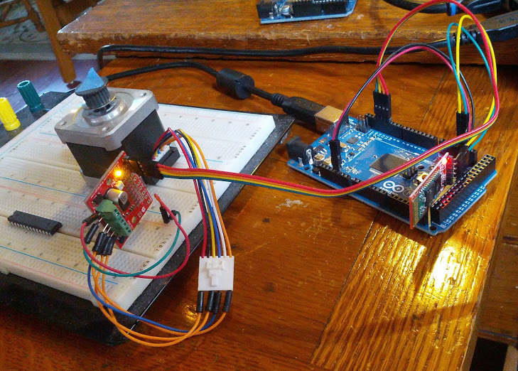

A stepper controller such as I linked to above is very simple and cheap, eg. just a suitable Arduino board plus a stepper driver module, and load the free firmware.
The author of that included a photo of a test setup - an Arduino mega and a little driver board>

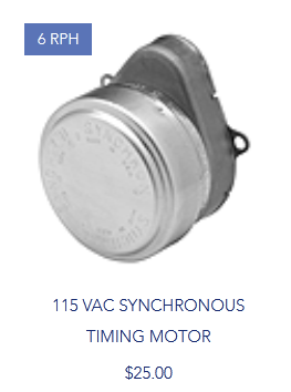

I'd like something simpler. What about a very slow AC timing motor with a light dimmer switch ? The one shown is a 6 RPH, but there are other speeds as shown on Herbach and Rademan.

AC timing motors are speed locked to the AC line frequency, not the line voltage. So you'd need to change the 50/60 Hz frequency to adjust the rotational speed. Otherwise you'll need to find the right speed, or add a gear train to get the right speed.
I opened a new tab and typed that in. It doesn't look like changing the frequency would be that easy unless you have a trick. Maybe DC motors are easier to work with. Thanks

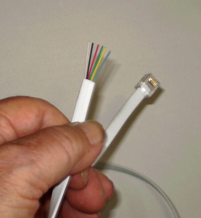

CONTINUITY: I decided I'd try to check the continuity by stripping down the ends of the cable and plugging it into the mount. Using my (cheap) multimeter how should I go about this ? Sorry I'm slow at answering. I'm recovering from surgery and sleep a lot.
