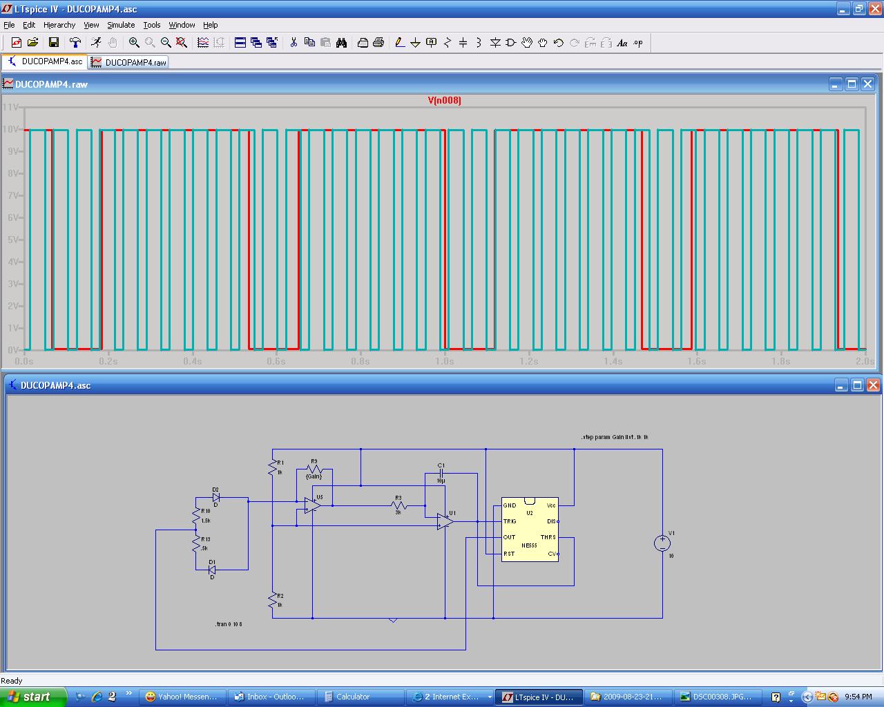

Ive used the first circuit to get a working PWM generator, without R1. Trying to get both frequency and phase width adjustment doesn't really work. I've simulated a circuit that gvies both adjustable frequency and duty cycle ( see attached ) I uses two op-amps in addition to the timer. Never built it though.
( the two resistors on the far left side model a center-tapped variable resistor )
( also, the opamps must be chosen for high enough slew rate so you have a rectangular signal )

I managed to get both the 555 circuits to work. I could adjust both frequency and duty cycle. The catch was that the duty cycle doesn't remain constant, it changes when the frequency changes so it's not very useful.
Thanks for the circuit you provided.
I have never worked with opamps so I have no clue to their properties in use or what is required. What would you have chosen? Could you suggest some models you think might work?
With the resister the duty cycle can be changed, I suppose as with the standard astable that the R1 and R2 are for frequency adjustment?
And does this design keep the duty-cycle constant when the frequency is changed?
I wouldn't waste my time with those circuits.
It depends on your performance requirements. If, for example, you're driving +/-12V square wave at 100Khz, and you want the 'switching' portion to be, oh say 1% of the waveform, then you can calculate the required slew rate as follows:
1/100Khz = 10uS period
10uS*.01 = 100nS switch time.
So, you need to slew 24V/100nS or 240V/uS. If you used a slow 741 at .5V/uS, you wouldn't get much of a signal. Use this analysis, then use one of the opamp manufacturer's web search facilities to find an amp that has the minimum performance capabilities.
The duty cycle in this design is totally dependent on the center-tapped variable resistor. The frequency is totally dependend on the other variable resistor (shown as "gain" on the drawing)
