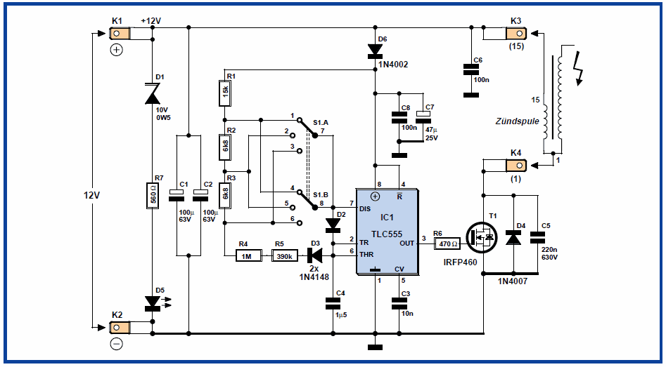

Hey Electro Tech, I want to build a High Voltage spark generator using an ignition coil. Ive read that using PWM circuit work great for this. So I was looking at this kit,
Its a motor speed controller, but could I use this to drive an ignition coil.
It would be easier and much cheaper to just build one yourself. All you need is a basic Timer IC like a 555 or something similar to drive a high voltage Mosfet or IGBT switching device.
Generally a PWM motor controller should work.
Consider the high clock frequency when pulsing an ignition coil, which might overheat.
Here is a cheap circuit using the CMOS-version (TLC555) of the NE555.
The PRF (pulse repetition frequency) is fixed at 1 to 1.5 cycles/min with selectable pulse widths of 16.5, 24 and 31ms.
Boncuk
Note: S1 is a double pole three position slide switch for circuit safety reasons. If a single pole switch is used and fails the timer output might constantly go high causing the ignition coil to overheat and "kaputt". Don't omit the fuse for that reason.
