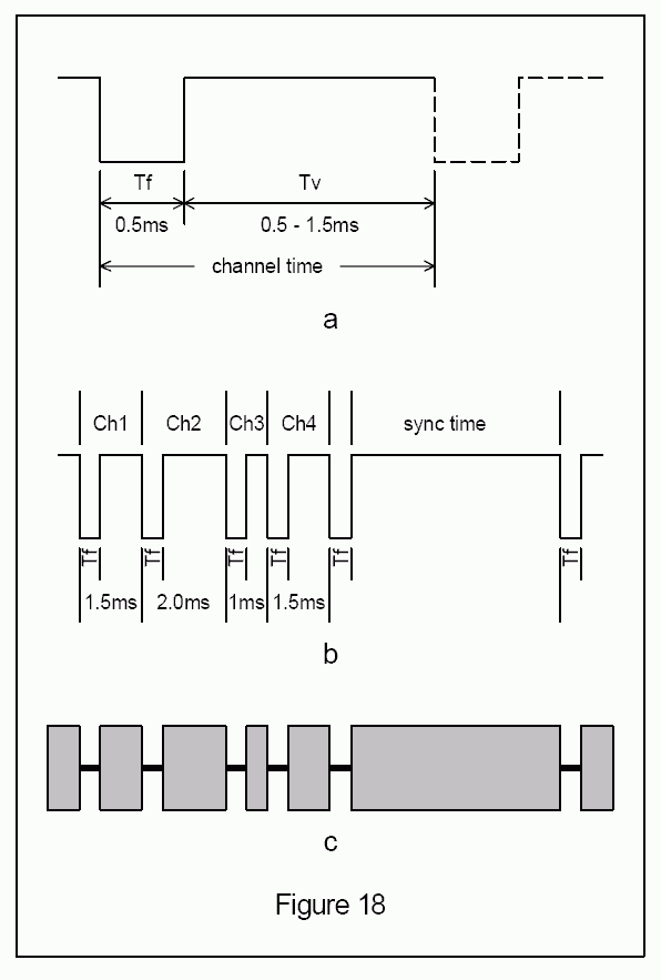

Unless you have a PCM transmitter and reciever you can 'or' the servo signals into the single capture module, the pulses never occur at the same time, but you would have to use the first channel as a trigger to reset the internal ICP flow. Again this is very much like the PPM signal is naturally transmitted, if you can tap that in the receiver you can decode it directly without all the wires.
There's no requirement of PPM to have a fixed duty cycle.
Then it would be called DPPM (differential pulse position modulation), which encodes symbols using the period between pulses.
But the signal itself is encoded in the pulse width as well, suffice to say it's a hybrid method of modulation.
I don't believe it's hybrid modulation. There is a 0.5ms pulse, followed by a variable idle time, hence DPPM. Try inverting the 'PPM' signal if you can't see it.
The actual signal they receive is NOT a fixed .5ms pulse. It's an analog .5 to 2ms pulse followed by an idle period preceded by a frame fresh. The servo's themselves only see their own pulses because that's that what decoder does, it hides the sync pulse and sends each additional pulse that is not a sync pulse to the next available servo line. 4 channel receivers will still accept 5+ channel signals, they'll just eat everything after 4.
And how long is this 'idle' period? Possibly 0.5ms?
Pretty pointless knowing, as you don't ever see it.
Your mistake appears to be that you are looking at the signal sent out of the transmitter, and not the servo pulses supplied from the receiver.
All the servo signals are, is just a single variable width pulse, 1-2mS long, repeated every 20mS or so. That's it, nothing else.
Personally I consider it misleading that people keep calling it PWM, it makes people think it's what the PWM module is designed for (and it's not) - however, I suppose it is a limited type of PWM.
No, your mistake. I was talking about the so-called 'PPM' signal used to modulate the RF signal.
For a constant frame rate, the signal going to the servo is PWM.
