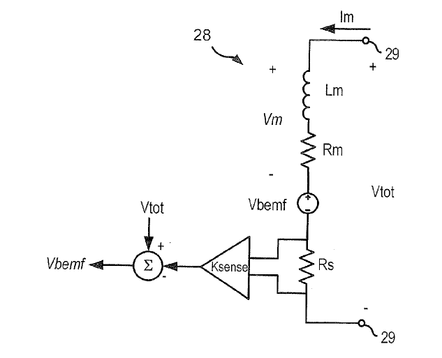

I found a patent online where a fellow is putting a sense resistor in series with the motor. He then measures both the total voltage drop over the motor terminals, and the voltage drop across this sense resistor.
He can use this to estimate the back emf.. are there other ways to do this?

No. The inductance of most motor windings does a pretty good job of smoothing out the current. Some filtering is still in order though. You're likely switching enough current to introduce noise without a solid ground and decoupling.
You don't need to be concerned with back EMF or forward EMF for that matter. Just measure the (filtered) current and keep it constant.
It's not hard to filter the high frequency PWM ripple with an aggressive filter, as you load is generally quite slow (as is motor inertia) so just filter the current feedback signal and use it to control the PWM.
So I should just try and measure the voltage over a sense resistor on the low side of my driver? I do have some 1 ohm, 3 watt resistors handy. I guess ideally (if I had the parts) I could also use a much smaller resister value (like 0.1-0.3 ohms), and then use some sort of difference amplifier to boost that signal up to voltage input range of my dsPIC's A2D converter.

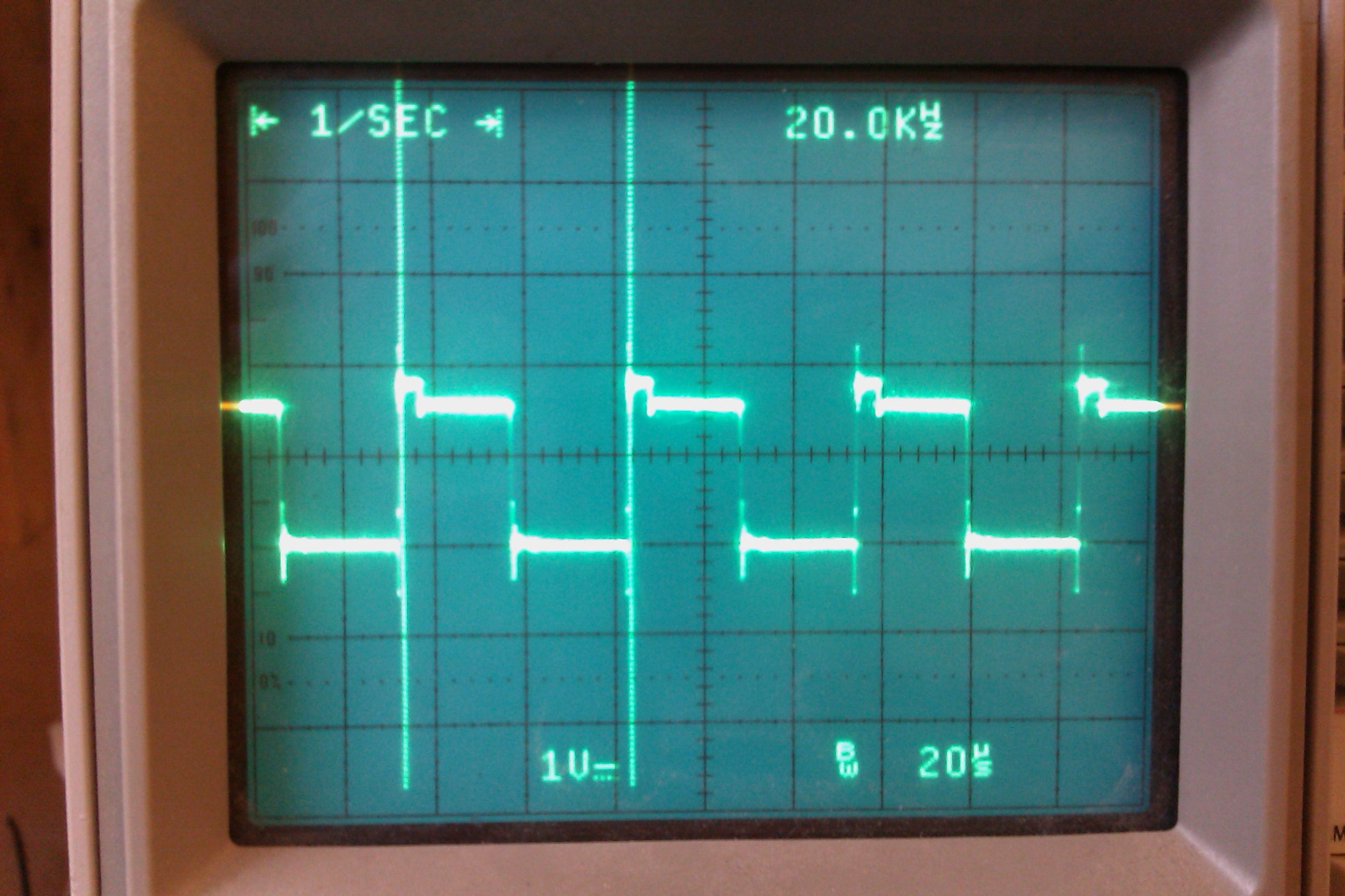

Here are some waveform results from my scope.
In this experiment Im using locked-antiphase pwm, so 50% duty-cycle commands no current to the motor. I've shown the voltage measured at motor terminal B. Terminal A's voltage is just the opposite of this waveform.
I've put two 1 ohm sense resistors in parallel (so 0.5 ohm equiv) out of the senseA output of the L6205 (which comes out of the bottom side of the bridge to ground).
The second scope image is the voltage measured over these sense resistors. One problem with this measurement is it gives me no information about the direction of current flow.. as shown.. you see the waveform at roughly 50% duty (so zero net current).. the second half of the waveform should actually be reversed.. because the current is flowing the opposite way through the motor. Its just that I cant distinguish direction when measuring at the bottom of the bridge.
Also.. when a voltage in the motor is generated due to back-emf will I be able to sense this with my sense resistor at the bottom of the bridge?
Note: using 10x scope probes.. so 1V division is actually 10V... my supply voltage to the h-bridge is 18V

You need to add an RC filter (integrator) after your current sense resistor so you get a nice stable DC feedback proportional to current.
You won't need to measure current in the reverse direction ever, unless you need to generate a reverse torque by applying a reverse current.
You won't need to sense back EMF or try to control it in any way. The torque produced by the motor is (roughly) based on the current through the motor so just keep the current constant.

One thing I have found that partially works.. I've put a 0.5ohm shunt resistor in series with my motor similar to that schematic I posted a few posts earlier. I measured this current using two ina168's (one for forward current, and one for reverse current). These little current monitor chips provide a nice analog reference signal that is proportional to my current output. I then fed both of these through the A2D of my microcontroller... subtracted the two signals.. and now I have a nice current reference in my software.
This somewhat worked.. my problem is signal noise. I used these signals as my reference for a proportional current control loop, but they are noisy enough that I hear a gritty kind of white noise sound coming from my motor. I tried different capacitors to clean up the signal, but have had no luck.
