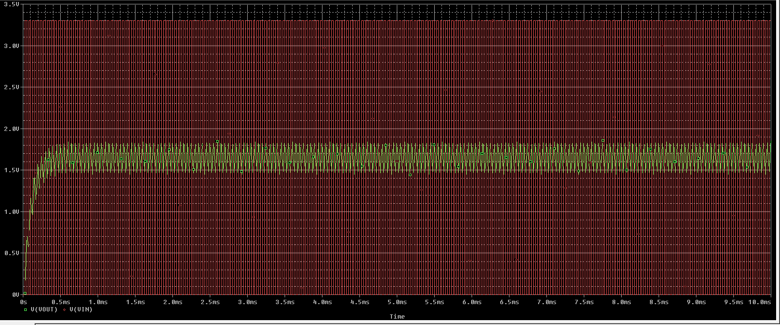

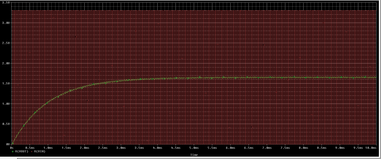

I'm working on designing a passive LPF to use with the PIC PWM output. I have the frequency set at 20Khz, 3.3V right now just for testing purposes. First I need some clarification into my understanding of how a LPF should really work.
I understand that we want to eliminate the high frequencies, so does that mean that the lower the cut-off frequency is from the LPF the more accurate the average output will be.
For example I have a LPF with R = 1K and C = 1uF. This will be a Fc = 1/(2piRC) = 159Hz.
I've attached what the simulation looks like for two different scenarios, the second one uses 100nF for C. I've done a couple of different simulations and noticed that the ripple of the output is worst with with lower capacitance, but rise time is faster. With higher resistance the ripple is better, but longer rise time for vout. So my question is how low of a cut-off frequency is a "good" cut-off. Any input will help. I've been reading a lot a still don't really get, but I think I'm almost there.

It depends on how much ripple your application can put up with. For low ripple, use larger resistor or larger cap or both. For faster rise use lower. For both you'll have to use a better filter, possibly with inductance or active filter.

Not really. It depends upon the effect of the ripple in the application circuit. If the motor control IC's reference input can respond to the frequency of the ripple than that could be a problem. If the frequency is higher than the frequency response of the reference input then it shouldn't be a problem.
If you don't know the frequency response of the reference input, then you may need to measure it to determine the acceptable ripple it can tolerate.
You should design the RC filter to cut off all the frequencies you don't need.. so design the cut-off frequency as low as possible. You should also use as high pwm frequency as possible. That is a trade-off between resolution and frequency (output ripple).

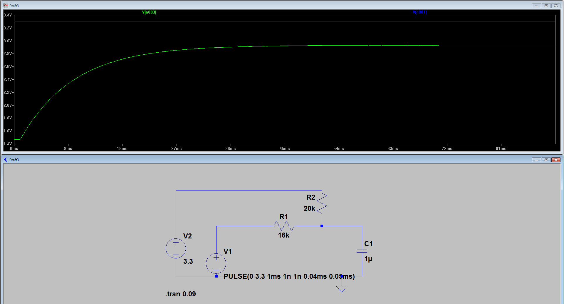

Use a passive RC filter with long time constant (low cut-off frequency ~10Hz, R=16k, C=1uF). You will get a nice soft start for the motor current and small ripple for Vref voltage.
Ok, so my question now is for the example you posted 16K and 1uF, the response time will be 5*RC?
So basically it will take the circuit 80ms to be stable? Is this the correct way of doing it?
Something like that. It will take the signal to reach 63% of the final value in 36ms. After 80ms it has reached around 99% of the final value. But why are you concerned about this? Why is the rise time important when all you need is a dc voltage reference?

For faster and more accurate output you can also use a "pullup resistor" to set a low-limit to the output. This way you won't get zero output voltage, but why would you in this kind of application:
