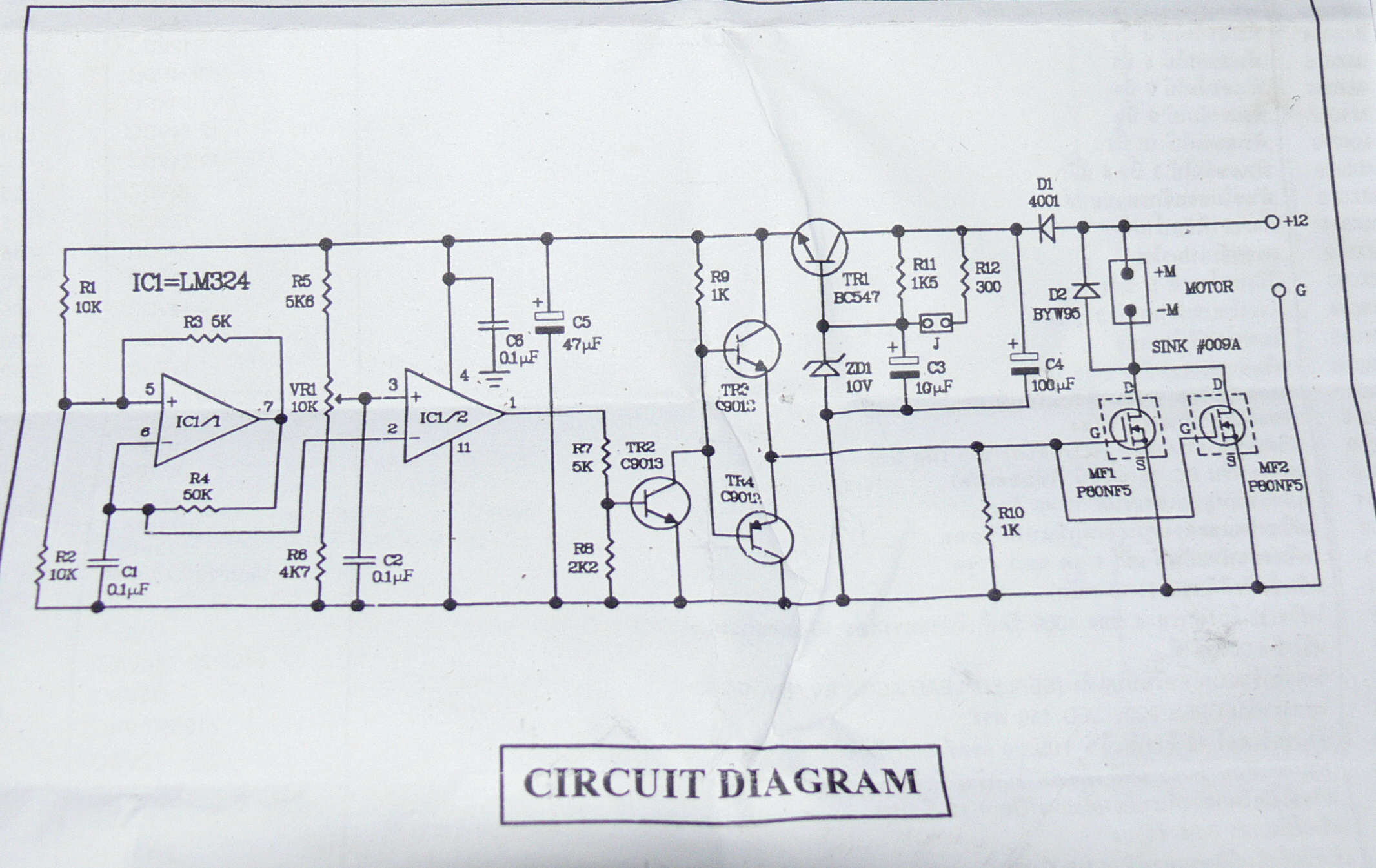

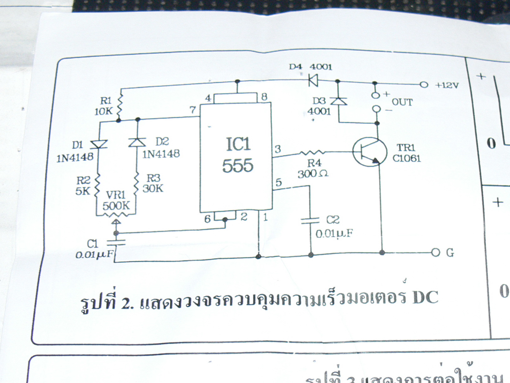

I have a 30A DC Motor PWM controller. it already has a 12v-24v jumper so I can use either voltage..
But I have a small 25watt PWM controller that works for 12v..
is it possible to use 24v?
I attached 2 circuit diagrams the large diagram is the 30A motor controller,
the larger diagram top right area of the diagram is [J] this is the selection jumper for 24v.
I dont require 12/24v only 24v for the small circuit..
I will be driving a string of LEDs approx 6 or 7watts max.. thr 30A is overkill.
if you require other information about these kits.. please ask..
thanks for you help
Shaun

You can modify the small diagram for 24V@30A.
Reduce R4 to 10R
Power the 555 timer from an LM7812.
And replace Tr1 with a suitably rated power MOSFET.
I do not require a Large Load
maximum is 7watts... very small loads..
I only require the small circuit to work @ 24v...
I am thinking I'd only need to change the value of 1 or 2 resistors. and by how much.. I dont know..
I hope you can help to just adjust it to work with 24v..
No, the 555 has a maximum voltage rating of 15V.
You need a voltage regulator.

I cleaned up the fuzzy JPG you posted using the Gimp and added the voltage regulator.
Is C3 a ceramic type cap?
or one of those round ones with +/--
Yes, ceramic is fine.
