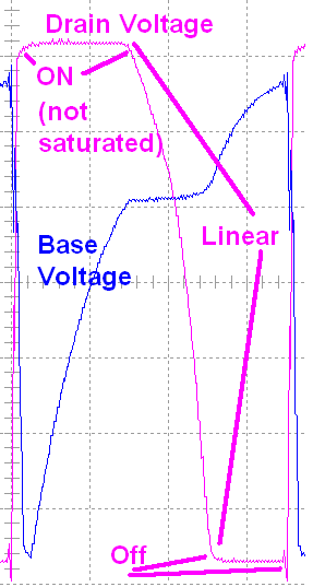

smanches, Sceadwian, I agree with what you guys say, and saturate may have been the wrong choice of words, But what I want to discuss is the effects of high vs low frequencies on a power FET. As I see it, the power dissipated in a power FET is Rds times the current squared times the on % of the PWM + power generated during the linear part of the cycle during turn on and off. At 1KHz, you have the Rds power + 1000 "linear" pieces and since, I assume, each linear piece is basically the same, at 20KHz you will have the same Rds power + 20000 pieces of linear power.
On the attached drawing, would you indicate what you call the different parts of the wave form if different from what I called it.

Your are correct in that, for a given switch rise and fall times, the higher the PWM frequency, the higher the switching loss in the MOSFET. But if the MOSFET gate is driven such that the rise and fall times are a minimum, then this loss is a small part of the total dissipation, most of which is due to the MOSFET on resistance, even at a higher switching frequency.

Kinarfi, you can't see saturation in most waveforms like that. It actually takes pretty specific drain-source and gate-source voltages to get into the saturation region. Most switching circuits will never go into the saturation region because of this. The higher the gate voltage, the wider the linear region gets (and hence less Rds_on) which also shrinks the saturation region at the same time. Took me weeks of reading to finally understand it.

I don't know if the graph you displayed is from your actual circuit but it's not good. See how crisp and sharp that turn ON phase is? A better mosfet driver should be able to get that linear slope during turn off to go away, rise and fall times on a MOSFET should be symmetrical so it's probably a deficiency in the gate driver.
FYI that was a P FET so it had to be an IRF4905, 40us/div and 2v/div ---- 4 1/2 div @ 40 usec =180 us 1/180us= 5555Hz
