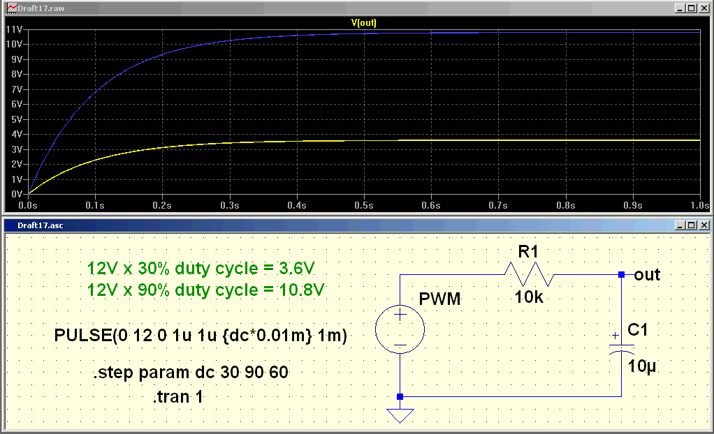

is it possible to link me to a schematic or more information? Since looking up RC integrator on Google seems to show, least in my eyes, a device that takes the on/off square way of a PWM and turns it into a saw wave?? Sorry if i'm not getting it, i'm still very much a beginner

Here's a simulation of integrator function. The curves show the result for a 30% duty cycle and 90% duty cycle 12V PWM input respectively.
Why thank you sir, like i said most results i seen online via google search seemed to result in a Saw-tooth like output. I've been playing around with the Picaxe software (love the drag and drop feature, perfect for dumb ass like me) now i need to see how i can set it up to notice a voltage into into one of the pins of the 08M2 chip.

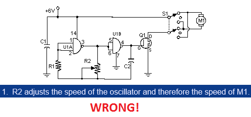

Maybe you saw this defective PWM DC Motor Speed Control circuit on the web that changes the frequency instead of changing the duty cycle. It does not change the speed of the motor and it will not dim lights:
You are correct.
Integrating a squarewave does cause the waveform to become a triangle waveform but the up and down motion is very small if the resulting RC lowpass filter has a low cutoff frequency.
If the squarewave is actually PWM pulses then the integrated waveform is a sawtooth.
