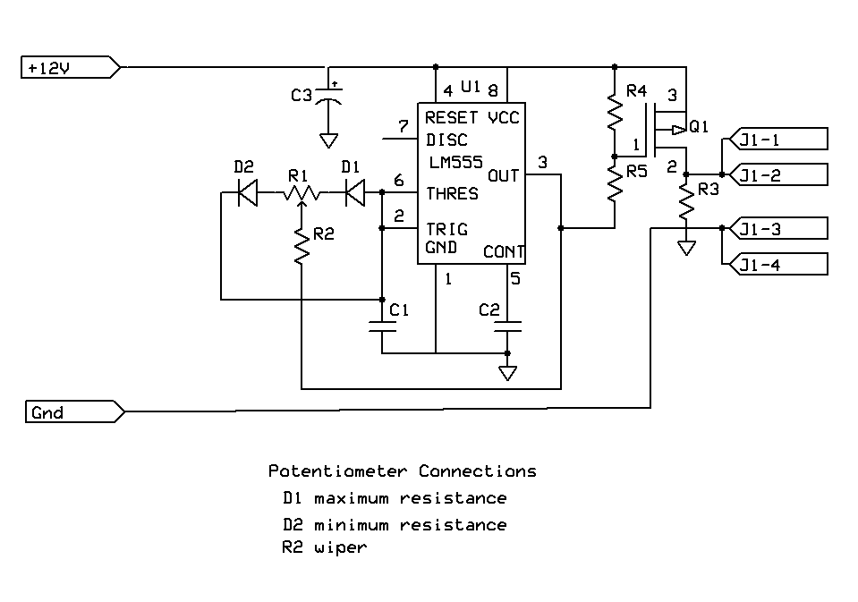

Here is a circuit I have recently built that works quite well, times are 93%on and 13%off. The P channel mosfet will control several amps. The IC is a 555 Q1 is IRF4905. If you want the other values let me know.
