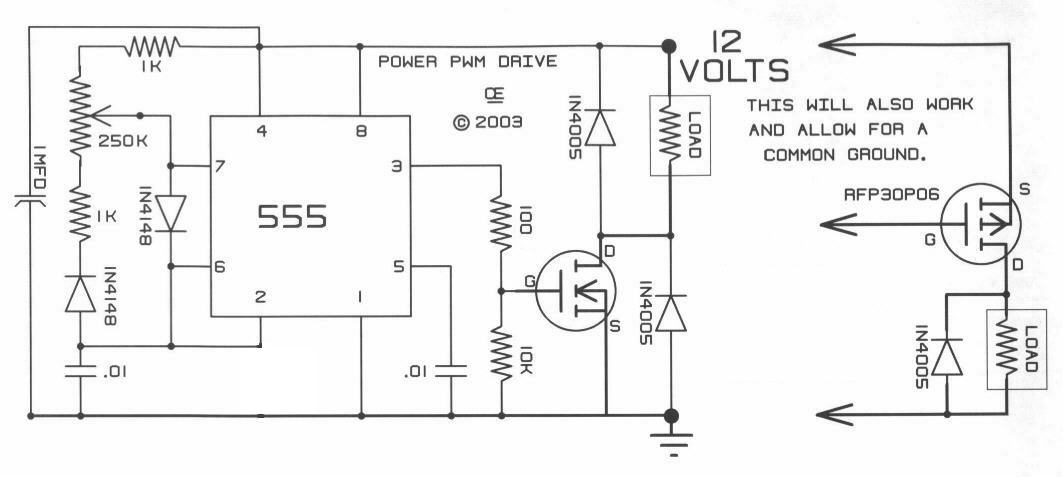

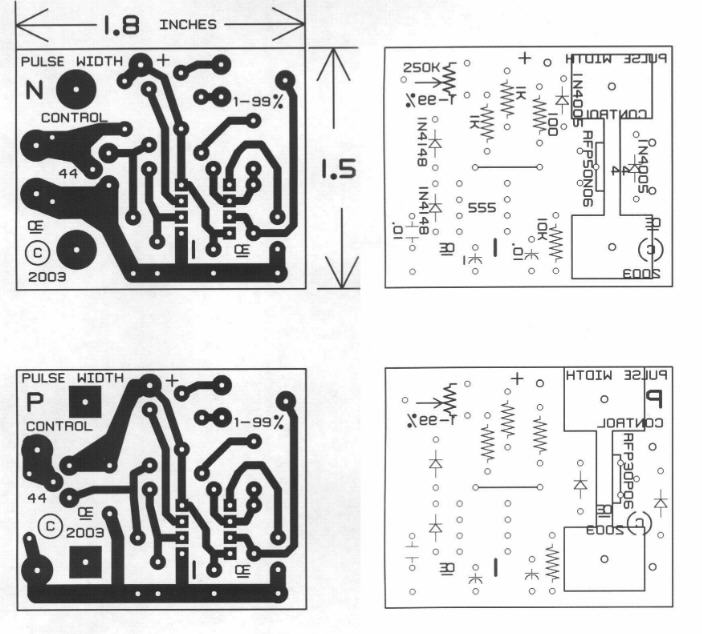

Here is a 555 PWM

hey all sorry I was a bit fed up the other day please exscuse me I'm not normally liek that it's just that I seem to run around in blasted circles. As it is so difficult to get parts here in Italy I want to make a generic pw modulator that i can use for anything from motor speed control to audio amplifiers 1 w to 100 watts. that way instead of waiting six months for this IC and that IC i just work out a generic pwm and use the apropriate driving mosfet.
hotwaterwizard, I was thinking of something like that myself but want to make something that can be used in an amplifier as well and maybe as a power supply control.

Not a good idea, they have VERY different requirements, you should build them for their specific use.

LM4651 is a PWM driver that can be used to drive other components like Mosfet or Standard Transistors etc.
