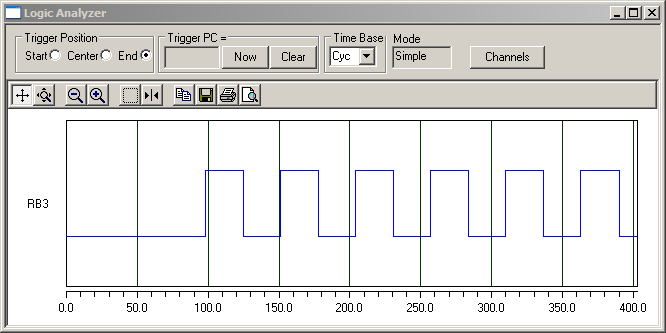

This code starts the PWM on Junebugs RB3, you can watch RB3 using MPLABS simulator / logic analyzer.
// 37.7kHZ PWM IR carrier signal
#include <p18f1320.h>
#pragma config WDT = OFF,OSC = INTIO2,LVP = OFF
void main(void) {
    OSCCON=0x72; // speed up the clock to 8MHz
    ADCON1 = 0;
    TRISBbits.TRISB3 = 0;
    PR2 = 0b00110100 ;
    T2CON = 0b00000100 ;
    CCPR1L = 0b00011010 ;
    CCP1CON = 0b00011100 ;
    while(1) {
An IR LED on RB3 with this running should pretty much jam any nearby IR receivers.

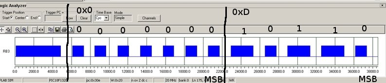

This is what i have so far just as a text looks promising :D
Trying to send 0x0D or in BINARY 0001101 since the command code is only 7 bits long i assume you take out the first zero which would usually be bit 7.
void MyDelay(int xD)
	int countA = xD ;
	while (countA > 1)
		countA = countA - .1;
void main(void) {
	char dc ;
	char dc2 ;
    ADCON1 = 0;
    PR2 = 0b00110100 ;
CCP1CON = 0C ; // 0%
CCP1CON = 1C ; // 50%
    while(1) {
		CCPR1L = 0x1A; // Start
		MyDelay(24);
		CCPR1L = 0x00; //Space
		CCP1CON = 0x0C ; // 0%
		MyDelay(6);
		CCPR1L = 0x1A; // 0
		CCP1CON = 0x1C ; // 50%
		MyDelay(6);
		MyDelay(6);
		CCPR1L = 0x1A; // 0
		MyDelay(6);
		MyDelay(6);
		CCPR1L = 0x1A; // 0
		MyDelay(6);
		MyDelay(6);
		CCPR1L = 0x1A; // 1
		MyDelay(12);
		MyDelay(6);
		CCPR1L = 0x1A; // 1
		MyDelay(12);
		MyDelay(6);
		CCPR1L = 0x1A; // 0

Trying
I know my Address is 0x0D and my command is 0x00 for sending a 1. But nothing happens with below code....
