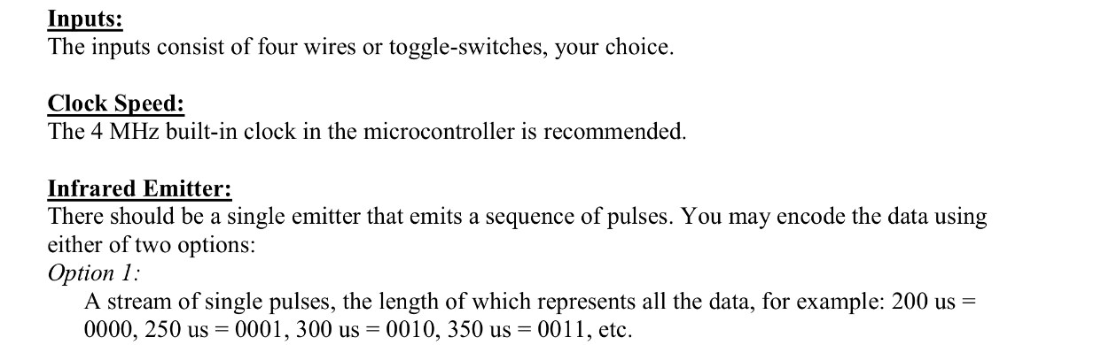

im new to using this language and im trying to figure out how to set up the micro controller to take 4 inputs and out put different pulse width modulation using C language if anyone can help thanks
You have 8 channels of ADC, but no CCP (PWM) module. So, you will need to write software PWM and control that with your 4 inputs. You have a 16-bit and 8-bit timers. I am assuming the inputs will be analog. If digital, then, will they be serial? Are you required to use that chip?
Can you give the equations that describe the relationship of the 4 inputs to the PWM output? What resolution and frequency do you need for the PWM?
EDIT: Are the "four inputs" to be consecutive bits of a port and considered a "nibble"? For example, that would give 16 choices for PWM duty cycle in its simplest form.
my instructions are posted on the figure below. figured that by using a while loop and for loops would create the PWMs that i need. any suggestions ( first time ever programming this type of chip)

That is a type of PWM, but your professor has defined the high periods, rather than duty cycle. There are 16 high periods from 200 us to 950 us. I would use one of the timers to set a recurring interrupt of at least 1 ms -- probably longer, e.g., >200 ms, is better. Then I would use the other timer to set a pulse width at each interrupt of 200 us to 950 us depending on a read of the port with 4 switches. I would pull the port pin to ground with a resistor of about 10K , then connect to Vcc with the switch. This is, a pin connected to a switch that is "on" will read high (1) and when off will read low (0).
From that point, you need to design and post your schematic and code. Most people here do C, but I do not. I am sure they will chip in once you show your efforts.

What I would do is setup a 50 us delay (with adjustment for the overhead of a call and return and etc. -- about 4 to 6 us @ 4 MHz). Then read the port nibble used for input and add "4". Thus, 0x00 = 200 us on and so forth. Keep the LED pin on until finished counting down from "port value + 4".
