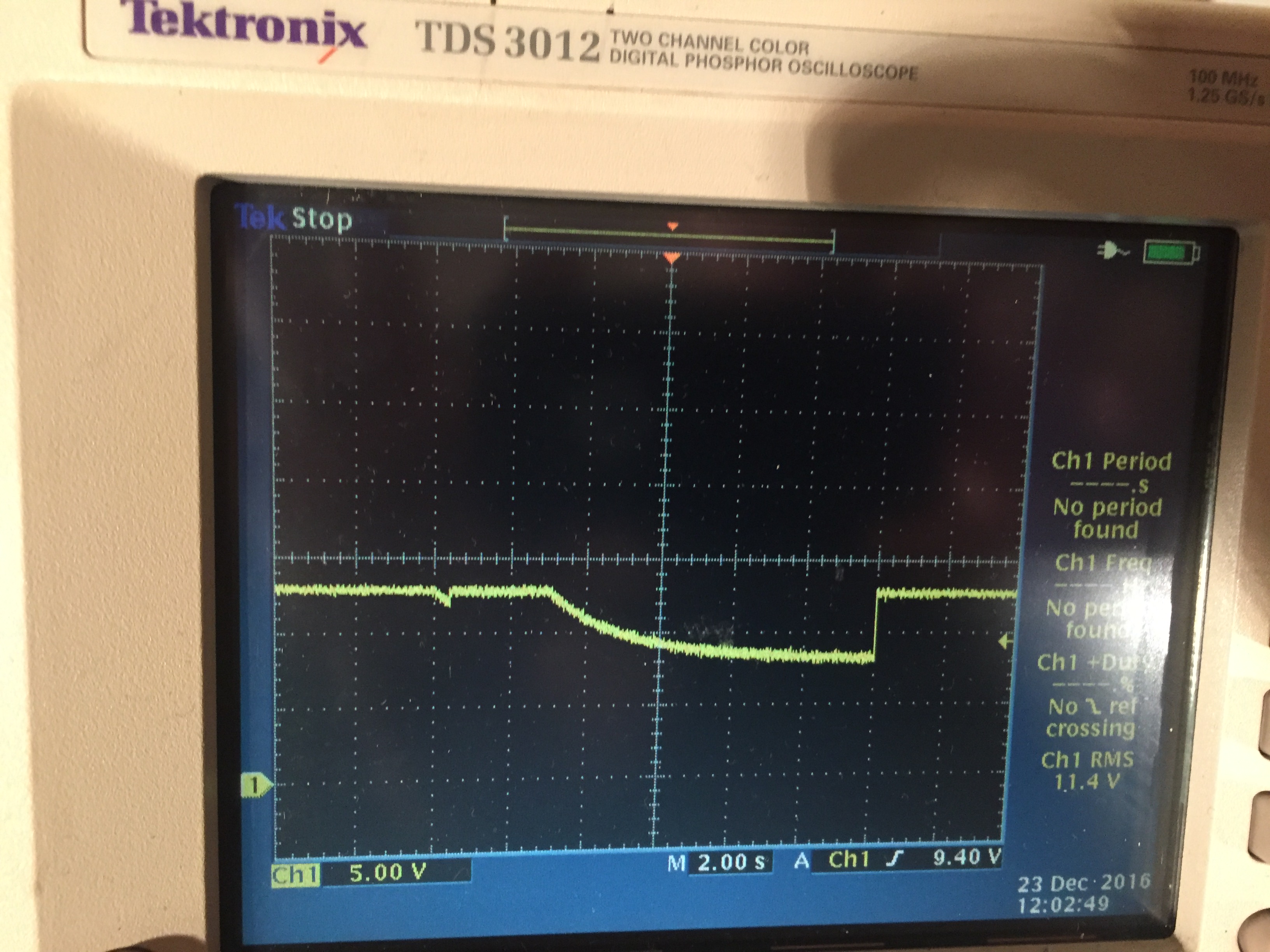

Let me explain the application, I have a kit car with a CBR1000 engine installed. Over the last few months I have been changing the dash, the old dash had a 12v LED installed to indicate neutral gear from the signal discussed above from the engine ECU (14v rms PWM duty Cycle)
I want to be able to identify all gears and display on a LCD.
Thanks MikeMI for your comments and it does seem like I need the frequency to build a valid RC filter, but I won't need a comparator because the DC voltage will go direct to my Microcontroller and I can read the voltage to know my gear selection. Don't need an amazing resolution as long as I can differentiate from the 6 gears it doesn't matter, I can also have a fair bit of ripple on the signal as long as the signals are separate and in a large enough window to see a change.

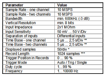

But an AUX audio PC input should be able to hear it and see it on PC with free AUDACITY ( like a scope and spectrum analyzer) . not sure why Pico would not.

You Pico scope isn't it able to show 20 KHz?

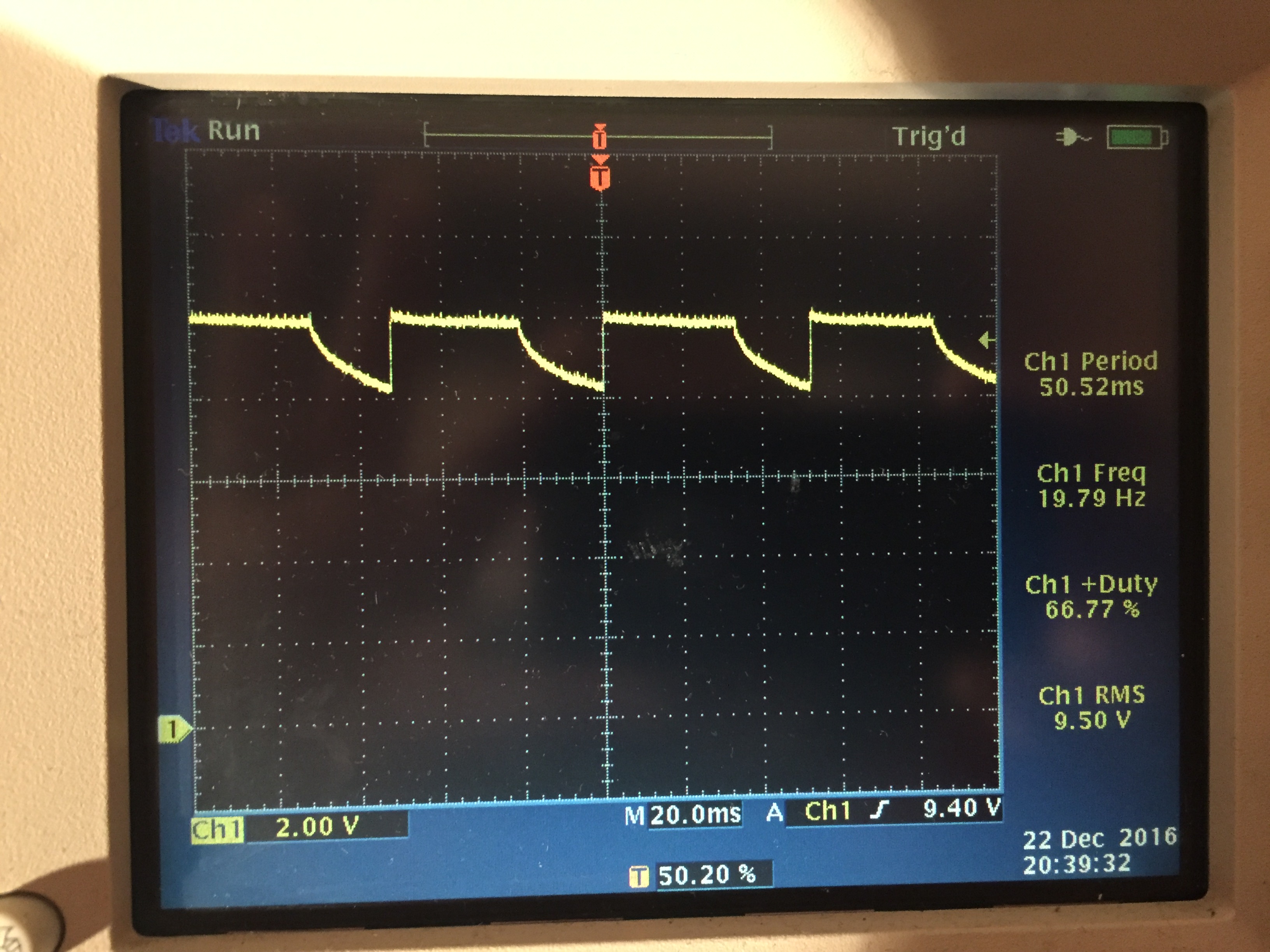

Hi Jason,
The waveform does not look like a PWM signal. Both edges should be a fairly fast transition. Your waveform looks like it is being loaded with a capacitor. the fact that the loading effect is only seen the falling edge looks like it is driven with active pull up but only a resistor to ground. It would be interesting to see af adding a resistor to ground improves the falling edge. I would suggest starting with a 10 K resistor. When you say "You can see me selecting first from neutral and then back to neutral." I do not know which two traces we are comparing.
Les.
Hi Jason,
I had miss read the timebase scale as 2 mS instead of 2 seconds so I assumed that we were looking at the same waveform but with a different timbase scale. (2 mS per div and 20 mS per div.) Are we looking at the raw PWM waveform or the output of the low pass filter ?
Les.
