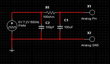

I know Joysticks are just potentionmeters that loop-back resistence, I'm trying to simulate that resistence. Oh, I was fiddling with Electronics Workbench to do a simple capacitor cut of a PWM signal and it worked pretty well for a DC voltage. With a given pulse width I can control the voltage, but I'm not sure how to tanslate that into an output resistance using the +5v feed from a joystick port to the app and then to the designated analog pins.
If anyone can help me with this I much appreciate it.
Current App:
(The X1 & X2 would be the pins on the joystick port.)

the game port works on resistance betwen ground(im not shue is its ground)
so you wod need an transistor to act as an resistor in your circuit
il draw you an circuit in a minute
Here it is
its in a simulaton
replayce the 10KOhm whith an potencimeter to set range
