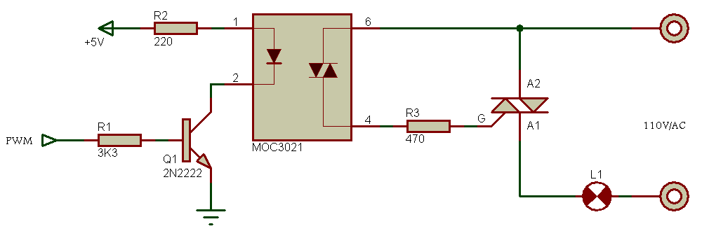

I wanna see is it possible to trigger a Triac by the PWM modulation?
I want to connect The A1 and A2 pins of the Triac to the Mains (110V/AC) through a bulb and control the bulb by the PWM modulation injected to the gate of the Triac through a PIC microcontroller.
Thanks beforehand.
Phase-angle control of a triac is the norm. Is your PWM frequency the same as the mains frequency?
Once triggered, triacs stay on until the current through them drops to below their holding current. You cannot turn them of under gate control. As such, you cannot control them with PWM like you can a mosfet.
You can control them with a PIC, but you have to decide when to turn them on, knowing that the turn off time is fixed. As alec said, the decision is phase angle related.

The high voltage section of what I want to design:

you need to know when the mains cross zero. This is when the triac turns off. For full illumination, turn back on immediately. To lower illumination, or dim, wait before turning on. This can be done with PWM, but you'd have to invert the signal and be in sync with the mains. In other words, instead of turning on for a certain amount of time before turning off, you turn off just before the zero crossing for a given amount of time, and then turn on again.
Easier to detect zero crossing and then delay turn on (up to 180°) before triggering on again, the shorter the delay, the brighter the light.
There are IC's that do all this.
Zero crossing triggering minimizes RFI (Radio Frequency Interference)
Just because the Pic runs at 60hz and the mains is at 60hz does not mean they are in phase.

while this is certainly true, and we do trigger at zero crossing (I use MOC3032), you can't trigger at zero crossing if you're trying to control power. Triggering at zero crossing will only net full power. Although, you can obtain half power by triggering at either other zero crossing.
agreed, which is why I said if you're using PMW, you'd have to sync up to the mains.
I dont want to appear as a lurker mike, however you can to an extent control power and fire at mains zero, its done with large loads in industry, burst firing modules do it, you can fire for a half cycle, then a full cyclle, then a full cycle and a half and so on, it doesnt give you a lot of control, but for large loads that take a lot to change, such as a 10kw heater the system works well and doesnt needs loads of filtering.
As far as the op is concenred however with lamp dimming the way to go about that is as mentioned phase angle control, you'd need an i/p to the micro that tells it the mains just went through zero, then a timer would start creating a trigger o/p when its timed out, the timer would be the opposite of the power level, zero being max power.

yes, I did mention you could cycle skip, but it is not commonly used on lamp dimmers. I suggested a opto for zero crossing because the reference design did not have a transformer. Transformer on the mains for isolation is by far the best design methodolgy. By far...
Yes and an opto as you pointed out in #11 makes things a lot safer.
If you dont go for isolation dont forget that all your front panel controls, pot etc need to be insulated as if they were connected to the mains.
