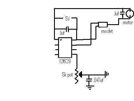

My project is to build an infrared RC system for indoor airplanes. Many have done it before that I could copy, but I want to learn to program. What I'm did first was learn to create PWM in software using a simple circuit. Then I put a potentiometer into the circuit to adjust the speed of the motor/force of a coil "BIRD" actuator. Later I will learn how to send the information over IR. The issue that I have is that the motor is not changing speeds when I adjust the potentiometer. I suspect that I am using the addlw improperly. The idea is to subtract the value read from the capacitor discharge time from 255 and get the bit high and bit low times of my bit-bang style PWM. I have included a drawing of the circuit and my code.

Not sure if you need it but your code does not save the W & STATUS on interrupt.
Also you must wait a small amout of time for the A/D to setup before you use it.
What I have done to keep from waiting for the cap to charge in the interrupt code is I leave the bit high all the time so the cap should be charged all the time until I want to read it in my interrupt. Maybe I should make my prescaler bigger to wait longer?
I think I should save the W value. Does this sounds right....I should save it because if the interrupt cuts in right when I'm in the middle of a high or low of the PWM it will finish the cycle with the value 255 instead of what I had there.
Yes save both the W and STATUS registers.
Here's some food for thought.
When you need A/D or PWM choose a PIC that has them in hardware rather than doing it in software, it's so much easier. The 12F683 has both.
Check the Toy Car project on my site to see A/D & PWM code for a 16F88.
I think it would be easier with hardware, but I want to implement up to 4 channels later on. With small SMD PICs I think I need to have the PWM in software to get that many channels. Also I'm simply interested in how to make it happen using a program.
So, what I have found is if I hold the pin where the pot is high or low it makes no difference in my motor speed. It should at least be all off or all on with that change. For some reason my value is not making it to the PWM cycle.
I agree, I'm more interested in learning to write the PWM and the IR code. The AtoD will be a lot more accurate done in the hardware. When I have the revised code for the 12f675 written I'll post it. Also what command saves the w and status registers?
You need to assign them to two variables, here's some sample code from Peter Andersons site.

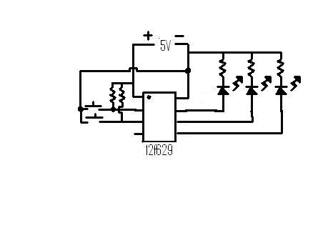

When using 12f629 and setting the program pin to out put there are problems entering program mode. In the menu bar >tools >VPP first program entry works most of the time. So pickit 2 problem mostly solved, now my program..... This is what happens with my PWM test program. It lights the led about half way when powered up. If I bring pin 6 or 7 high the led turns off instead of changing brightness. Any ideas about what I can change in my program?
You code sets pins 2 & 3 to input - not 6 & 7. I find it confusing when people refer to pin numbers, much better to refer to IO/Port numbers.
I'll use bits next time to describe the process. So after a little homework I got my PWM to work, and even threw in a few inputs. The first thing I learned is that an input that is driven low to activate needs to be held high with a resistor in the mean time. Here is the circuit and the working code for any newbies like me that want to see.
;PWM simple
	list P=12f629
#include <p12f629.inc>
	__config _INTRC_OSC_NOCLKOUT & _BODEN_OFF & _WDT_OFF & _PWRTE_ON & _MCLRE_OFF & _CPD_OFF & _CP_OFF
	ERRORLEVEL -302
	cblock		20h
	BH,BL,DELAY
	endc
	bsf	STATUS,RP0		;bank 1
	movlw	0x30
	movwf	TRISIO		;make bit 4 and 5 inputs
	bcf	STATUS,RP0
	movlw	0x07		;turn off comparitors
	movwf	CMCON
Start
	movlw	0x00		;turn leds off
	movwf	GPIO
test
	btfss	GPIO,4		;test for bit 4 low
	call	dim			;if low goto dim pwm
test2
	btfss	GPIO,5		;test if bit 5 low
	call	bright		;if low goto btight pwm
	goto	Start
dim
	movlw	0x04		;set on time of duty cycle
	movwf	BH
loop
	decfsz	BH,1		;count down the on time
	goto	loop
	movwf	GPIO
	movlw	0x04		;set off time of duty cycle
	movwf	BH
loop2
	incfsz	BH,1		;count up to the off time
	goto	loop2
	movlw	0x07		;turn leds on
	movwf	GPIO
	goto	test		;repeat until bit high
bright
	movlw	0x10		;set on time
	movwf	BH
loop3
	decfsz	BH,1		;count down time to keep leds on
	goto	loop3
	movwf	GPIO
	movlw	0x10		;set off time
	movwf	BH
loop4
	incfsz	BH,1		;count up to keep leds off
	goto	loop4
	movwf	GPIO
	goto	test2		;repeat until bit high
	end
