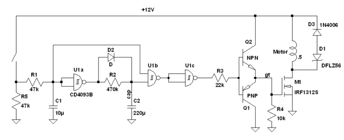

How about this? Cheap as chips. Timing won't be very precise (but you said you don't need that) and it can be built for just 2 or 3 $$. The components aren't critical and the MOSFET should be ok without a heatsink if a low Ron type is used. R1*C1 determines the start-up delay and R2*C2 determines the motor 'on' time.

OK do you think I can get a minute out of the R2-C2 combonashoin?
Easy. In a simulation the component values shown for R2 and C2 give a run time of ~90 secs. Just increase R2 and/or C2 for longer.
Could I do the timing with transistors and R-C combos instead of the chip?
That would be tricky with bipolar transistors, because they need significant base current which means much bigger capacitors. Why not use one CD4093B chip? It runs on nano/microamps, costs only a few cents and contains all three gates for the suggested circuit !!

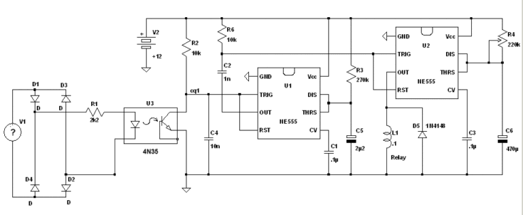

The output of the firring system is 24 volts of unknown polarity for long enough to fire an e-match, 1/2 a sec. or so. I would like to run this off other firring systems as well, some what universal.
The voltages can vary from 9 to 36 volts at differant pules lenghts. I don't know exactly how long but I can find out.

How about this then? Simulation gives a 1/2 sec delay then a 2 min 'on' period with the components shown. The opto gets 10mA with a 24V firing pulse (I haven't checked what it should be for a 2N35). Increase/decrease its series resistor for use with greater/lesser pulse voltages if necessary, to stay below its specified current max.
