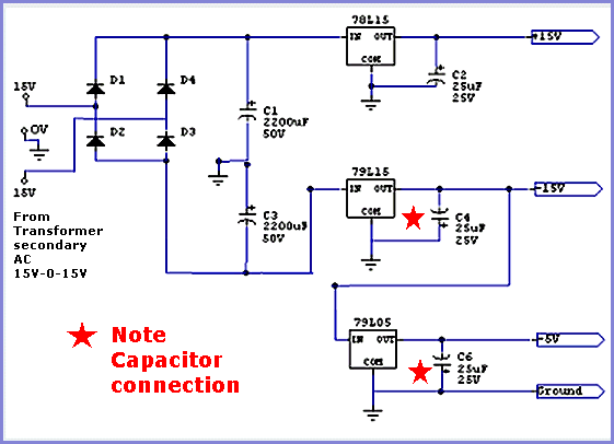

Input +15V AC==========> output +15V, -15V, -5V DC
we noe we can place a bridge FW & a capacitor to get a dc +15V
but how can we suppy +15V & -15V in ther same time? :roll:
so with the -15V we can so regulator LM 7915 & LM 7905 the have a output of -15V & -5V.
Result +15V, -15V, -5V DC
pls help thx u
Regards
Adrian

You need a 15-0-15 transformer, followed by a bridge rectifier, this will give about +22V and -22V. If you want +15 and -15 you would need a transformer about 10-0-10, or (preferably) use regulators to provide smooth stabilised supply rails.
But it depends what the supply is feeding!.

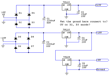

Over all circult
Sp a transformer itself has a +15V, 0V and -15V. by drinving across the bridge rectifier the voltage will drop 1.4V.
As a result, we can't use a transformer supplying +15V, 0V and -15V we must use a +22, 0V and -15V?
But we r told & given only 15V, 0V and -15V.
So how will the voltage reach 15V?
so from this circuit below wat can't it b improve. Like capacitor or replace by component lik bridge rectifier(replace D1, D2, D3 & D4)?
After a LM7815 & a 10uF, is it a need to place a zerner diode to improve the circuit?
there is 1 last qns in the diagram.
Thx alot for helping my :wink:
Regards
Adrian
You can do it fine with just tying one of your AC terminals to the output ground and the other AC terminal has one diode going to the +15v cap and another diode, reversed, going to the -15v cap.
3 things- it's a half wave rectifier so the ripple is poor. Also be aware a 15V RMS AC waveform, half wave rectified or fullwave, charges caps up to the peak voltage of the waveform, 21v. And AC sources such as transformers (as well as the line voltage source!) are poorly regulated in themselves, expect it to charge caps up to over 30v when there's no load on the transformer. So the +15v,-15v regs would be helpful.
Going though bridge rectifier it should become a fullwave rectifier.

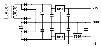

A possible circuit...
The electrolytics must be min. 1000uF 25(30)V. The other caps are 100nF.
It work fine with smaller currents only (about 100mA), because the 15V ac input give not enough voltage for 15V regulators. (keep in mind: all normal regs. need min. 2V higher voltage input as output for proper work! Some LDO-s works with 0.5V in-out difference.

This would help you out but you needs a center tapped transformer.

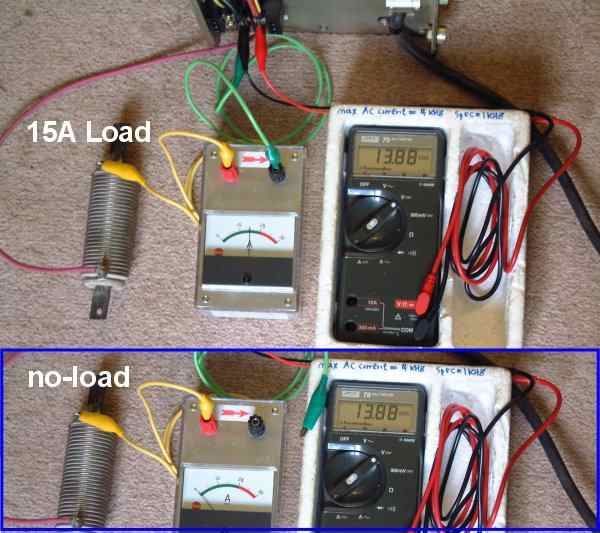

This is the power supply I built. See how yours perform using a DVM. :lol:
Hi L. Chung,
Your power supply has extremely good voltage regulation! :lol:
