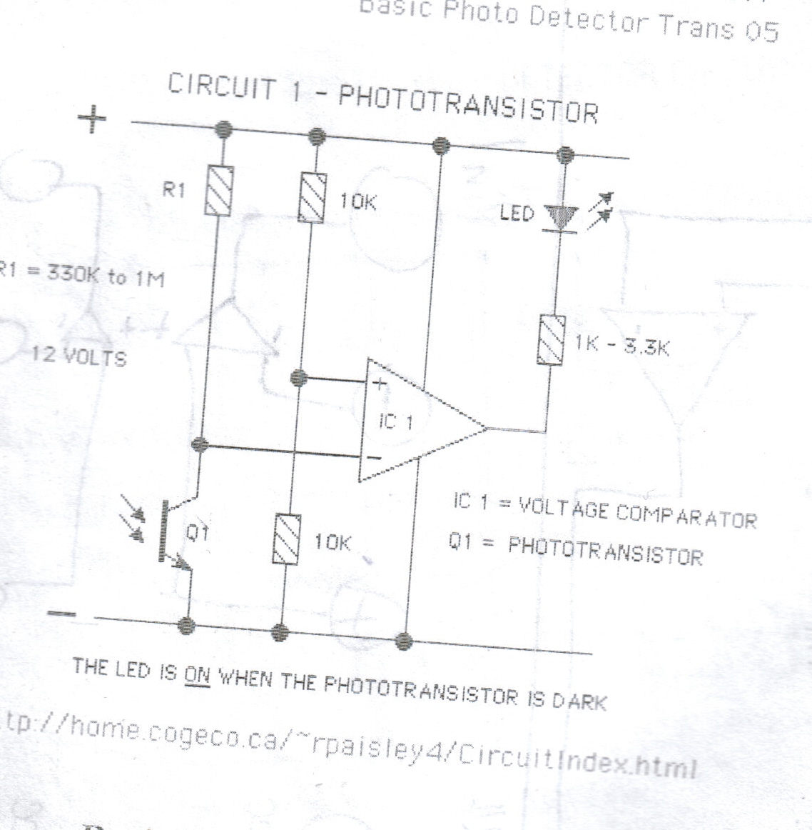

hopefully a picture. 5 lines going to the comparator. posative, negative, and output. where do the other 2 lines hook to the comparator when looking at the comparator 14 pin diagram?

They are the power supply pins. What pin numbers they are depends on the part number of the comparator.

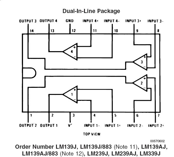

Here's the pinout for an LM339, if that's what you're asking about. If so, pins 3 and 12 are the power pins:

If it's an LM339, there are 3 unused sections. You can connect one input of each section to ground so that they don't oscillate internally, or affect the internal biasing of the one you are using. Look at the datasheet to see which pins the inputs are on.

Thankyou all. thats what I was asking. So how do you know where the power will come out with 4 output pins? Pins 1, 2, 13, and 14? which one do I wire to my relay?
The LM339 is a quad comparator, meaning there are four comparators in one package. Apply power to pins 3 and 12. If you only need one comparator, then use only one. Pick one! Once you've done that, then follow Ron's advice above, i.e. ground one input of each of the comparators not in use.

Perhaps what's confusing the OP is the fact that the comparator as used in the circuit is sinking current through the LED. He is probably expecting a wire to go to his relay as it would in a sourcing arrangement.
All that is necessary for him to do is replace the led in the circuit with his relay, and a suitable reversed parallel diode.
The LM339 is a low power quad comparator. The LM393 is the same but it is a dual comparator in an 8-pins package.
Because they are low power, their minimum output current is only 6mA (with a saturation voltage loss of up to 1.5V) which is too low to drive most relays.

Sorry about that guys. I was trying to upload a thumbnail and was having lots of trouble getting it done. (still on dial-up). As well, this stuff is quite a ways above my head so thankyou for your patience. I believe I now have enough info. to start building. Hopefully it will work. I hunted for quite some time to find relays with the lowest coil voltage possible.(5v, 69.4ohm,spst relay) Thankyou all for your input.
A 5V realy coil that has 69.4 ohms needs a current of 72mA. The LM339 quad comparator has a minimum output of only 6mA. It won't work.
You need a relay with a low current which would have a high resistance.
Or have the comparator drive a transistor that drives the relay.
What is the relay for? Maybe a transistor can replace it.
