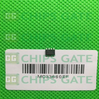

If it's a shared one wire and ground open-collector bus, a K line interface could work, as that's exactly how that works.
They also have all the protection built in.
This one looks to be readily available:
Alternatively you could use CANBUS transceiver ICs, even though you are not using CAN. It's still a single shared bus with high noise immunity etc. for multipoint applications.
There are a few ICs form different makers that have compatible pinouts, also.
It isn't what I was expecting, but the K Line looks nearly perfect. I have not heard of K line before. A quick google says it is for very slow data rates.
The automotive system is rather low speed.
However, from that device datasheet, the delay is somewhere around 2 - 4uS with 500pF capacitive load, so I'd expect them to work at quite high speeds? Quite possibly 115200 depending on cable lengths and loading, or 57600 should be fine.
