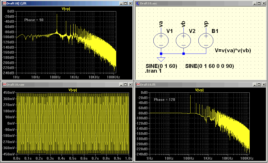

Here's the result of simulating the Fourier spectrum of the product of two 60Hz waveforms (which I reckon would be indicative of motor torque) with (a) a 90 degree phase shift and (b) a 120 degree phase shift.
In both cases the secondary peaks are ~30dB or more below the main peak at 60Hz; so IMO there is no real problem, particularly when motor inductance and motor/turntable inertia are taken into account.

Thank you for the thought, but I'm not convinced that plotting the product of two out-of-phase waves is really representative of torque for a motor with two windings in quadrature.
