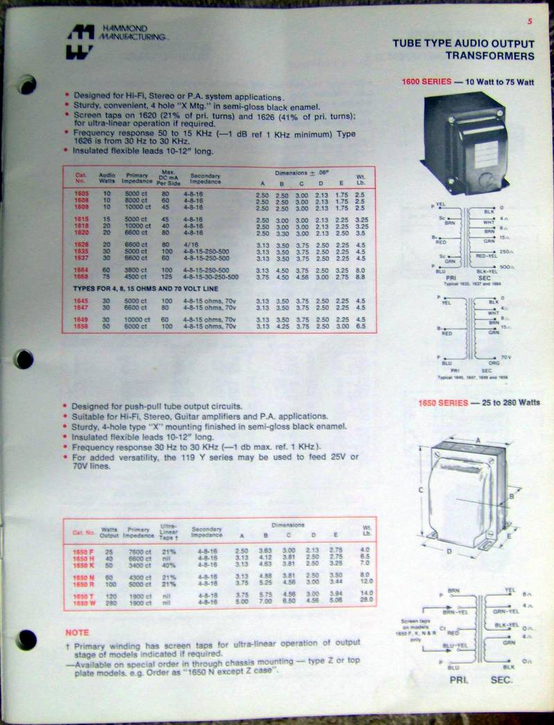

Tube Amp, Audio Transformers Probably Differ Mostly In Input Impedance Values.
Plate Circuits in Tubes are HIGHER Impedance than Collector Circuits in Transistors.
For a Good Amp, Proper Impedance Matching is Important.
As well as the Ability of the transformer to work at Full Load without Saturation.
So Testing these transformers "IN the Amplifier Circuit", Also will reflect on Proper Matching at both low and high power outputs. (And can also show any Saturation problems.)

Is there a good site somewhere or information that I can read up on matching Impedances correctly for tube amp design.
As you say the plate Impedance is high.
Cheers
Here is a Page from an OLD Hammond Catalogue, with Typical Audio Transformers and there Spec's.
Sorry, Most of my Other Tube Amplifier Info is LONG GONE!
