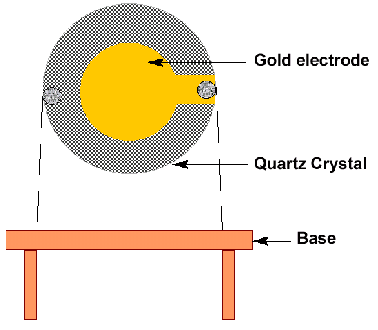

does anyone know the range of freq of these kind of quartz crystal speakers?
does anyone know if they work at 100KHz or more?
thanks

It looks to be a standard crystal with the can removed?. It will be highly resonant at one specific frequency, the one it's tuned to, usually in the Mhz region (although lower frequency crystals are available).
I don't see as it's any use as a speaker?.

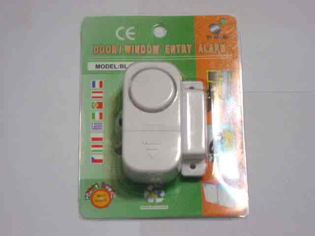

yest it is anormal crystal used in these kind of door alarms, i dont know what you call them so i could not find a good pic to put here.
Dr.EM said:
I assume this is the type of device you mean, commonly termed a piezo sounder;

Your transducer is not quartz, it is a cheap piezo. It doesn't have gold, most likely it is brass.
It is probably used in the security device as a vibration sensor/microphone, not ultrasonic. It resonates strongly around 4kHz with very little output above or below. As a microphone it will pickup a glass breaking sound.
Expensive ultrasonic transducers resonate around 40kHz with little output above and below.
I don't know of any transducer that can perform as high as 100kHz.

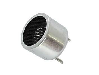

epilot said:
i know this coin buzzers abit but i never have worked with ultrasonic sensors so i need help about them too?
i'll try to see if i can find something about them in the net
Those types of ultrasonic transducers are normally resonant around 40KHz, transmitter and receiver are completely different devices (and are usually labelled T and R) - transmitters are series resonant, and receivers parallel resonant.
That's a nice expensive-looking ultrasonic sensor. Post its spec's so we can see if it is a mic or speaker, see how wide or narrow is its beam and how low is its max output power. Then maybe we can figure how much range a pair will make.

https://www.elexp.com/kit_0a5r.htm
why you call them EXPENSIVE?
i get a couple of those sensors for 1$ !
it seems you call those buzzers and ultrasonic sensors a" expensive transducer" , then i think you are talking about a expensive device not about an element
I don't know where to buy Velleman stuff. Digikey sells ultrasonic transducers for $26.00US to $120.00US.
