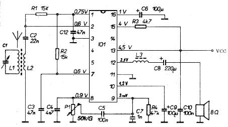

i recently made a SW radio using a **broken link removed** radio ic using the circuit below and it works but ( not as expected )
i have been able to listen to SW brodcasts from china - greec - even egypt !
but the circuit has the folowing problems :
1- most of the stations are mixed together (i can hear more than one station at a time )
2- the signal has a fading issue ( when i listen to a station and its clear ! after 10 sec or so the signal fade and i hear
another station and the firsts station may or may not come back) even that the IC has a AGC on pin 16 ?!
the ic are supposted to be a dedicated AM /FM receiver !?
so is there a way to improve the reception of that circuit?
Where are all the rest of the parts? - there's a distinct lack of any selectivity in that partial circuit, haven't you looked at the datasheet you linked to?.

You can obviously make an AM only radio with that IC, but you still need all the AM parts to make it work - as it's a superhet you need a local oscillator, IF, and front end tuning.
Note that the 'circuit' you copied says it's for MF (and a crap performer at that), altering it for short wave will make it even worse.

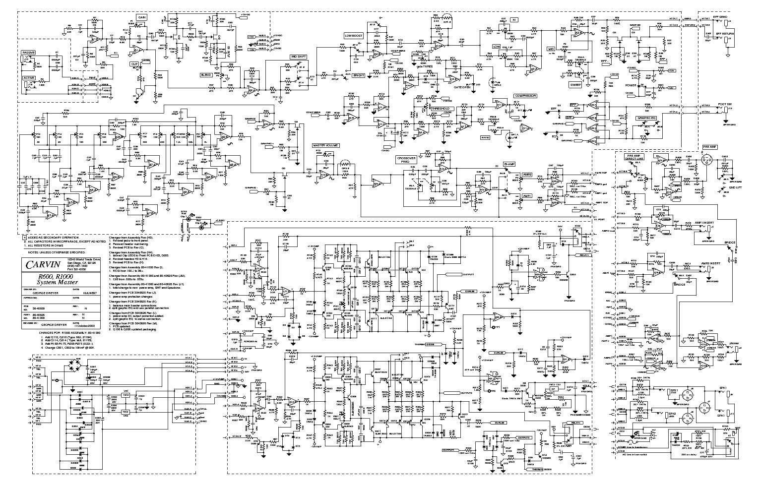

That is the schematic of a real shortwave receiver. If Kenwood could make and sell a decent one with as few parts as the one you showed, why do you suppose they would sell the one above?

MikeMI , ok i get the idea.
but nice schematic tho i defenitly should try it :joyful: hhhh

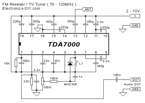

i made that circuit below while ago its an FM receiver with the tda7000 (notice that the circuit has much less component
than the keenwood one :cool:) and it works great ! the voice is crystal clear the selectivity is good and manged to pick all the stations !

i don't know what you have against the TDA7000 (its a good dude :cool:) may be against all the TDA series. i tried the TDA7000 circuit my self and its
far from terrible you can say it a relativly decent circuit the audio is clear , no hissing , no noise , the selectivity is good also (after putting a varicap diode )

The way you are using the TDA1083 in post #1 is not the way it was designed to be used. It is designed to be used as a superhet receiver which means that the selectivity is provided in the IF stages. The only selectivity in your circuit is one tuned circuit on the input. (Which will have quite a low Q as it is loaded by the antenna and the input of the IF amplifier which you are using as an RF amplifier.) The design in Fig 10 on page 8 of the data sheet is how it should be used as an AM only receiver. This design is for a fixed frequency as it uses a crystal controlled local oscillator. You would need would need to use a variable frequency local oscillator. You would need to use a two gang tuning capacitor so the input tuned circuit was tuned to either 455 Khz above or below the local oscillator requency (Depending on weather you wanted the local oscillator above or below the received frequency.) At higher received frequencies the image rejection would not be very good with a 455 Khz IF frequency. This is just a more detailed explanation of what all of the other replies have said. I think it would be cheaper to buy a ready made short wave receiver. I used to have a couple of synthesised short wave receivers that I took on holiday to listen to the BBC world service which only cost me about £10 each.

thank you so much les jones for the explanation ,
after a closer lock at the block diagram of the ic it became now clear to me that the circuit leves pin 4,5,6 not connected
which are strange becouse these are the most important pins of the ic ( the oscillator - the mixer ) ,
i propaply will stick with the datasheet circuit or buy a SW radio insted

Of course the TDA7000 produces clear sound without much hiss or noise, it is FM, not AM and it cuts high audio frequencies to reduce its hiss. But it was designed a long time ago with only a single tuned LC circuit when there were few FM radio stations to cause poor selectivity. Its spec's also show horrible distortion and noise.
Here in Canada a half-decent FM radio has many tuned LC circuits so that it can select only one local FM radio station from the 50 or more local stations here. Do you have 50 or more local FM radio stations in Egypt?
