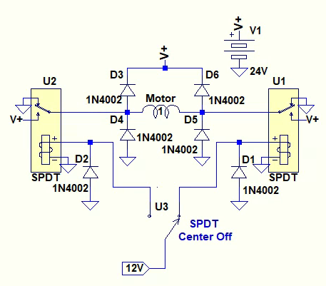

Hello and thank you in advance to anybody who helps me out. This is my first post hopefully it’s in the right place. I’m trying to build a little miniature winch mostly for fun just to see if I can, also if it works it would be cool to have something to drag logs up the hill with. I’m using a 24 V motor that was repurposed out of a hoverround mobility scooter. I’m using an on off on switch with a 12 V Li Ion battery pack to trigger 4 automotive relays (2 at each position) that will send 24 V from 2 deep cycle batteries to the motor. I’m under the assumption that I will have to deal with some back EMF from the motor when I change directions, I’m also under the assumption that that can be dealt with with flyback diodes. When I go to Google, I can find schematics that are what I’m doing, but there’s flyback diodes on all the coils of the relays but nothing around the motor. If it was only going One Direction, I know it would go across the motor terminals, but with a bi-directional setup I’m pretty sure that that cannot be a thing. I’m a doofus, and I already had one little fire and blew up a big diode, I’m gonna blame that on ChatGPT. Also, I’ll blame it on me, OK it’s my fault. I did it, if anybody could shine a little bit of light on this for me, I would greatly appreciate it. Thank you again.
Just diodes on the relays should be fine, and if you're just using mechanical switches?, no diodes at all would probably be fine as well - the diodes are there to protect the driver transistors, which can be destroyed by the voltage spike.
If you want to suppress any back-emf from the motors (which may not be needed for the relay contacts but couldn't hurt) requires four diodes, two on each motor lead.
One diode goes from the motor lead to the V+ (cathode to V+) and one from the motor lead to common (anode to common)

There are automotive relays that have a normally open connection and a normally closed one. The terminals are often marked 30, 87 and 87A. If you used those, you only need two relays. Wire +ve to 87 on both relays, and -ve to 87A on both relays. Connect the motor between the terminal 30 on one relay and the terminal 30 on the other relay.

Below is an example circuit using two SPDT (Single-Pole Double-Throw) relays to control.
The diodes to suppress the voltage transients are optional.
If you have only SPST relays, then you will need two on each side to make the connections.

lol all I had laying around was a fender three way pickup selector switch. I’m way up in the mountains, I only go to town once or twice a month and mail isn’t a thing up here (plus I’m broke as a joke right now) so I just harvest parts from the hoarder down the way. He doesn’t mind cause he likes company. That schematic is perfect, after I get this roof to stop leaking all over me I’m going to fire up the iron, grab my desoldering pump and get me some diodes. Thank you for the free knowledge, especially since you probably paid for it.
