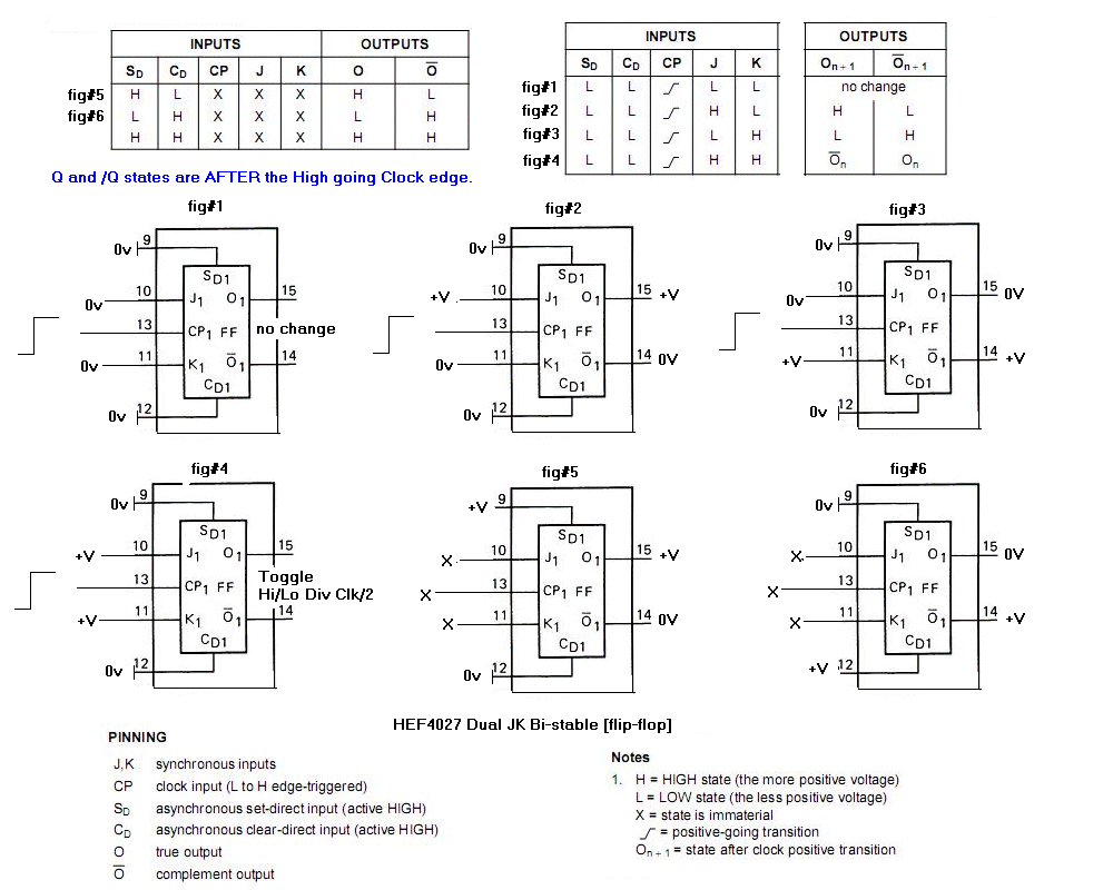

please help me with these circuits:
a JK flipflop using a D flip flop and a multiplexer
a 5 to 32 decoder using four 3 to 8 decoders and a 2 to 4 decoder,

For example, look at the characteristics of a D FF as compared to a JK FF and determine what signals you need to convert one to the other.

This should give you a little guidance for the JK.
